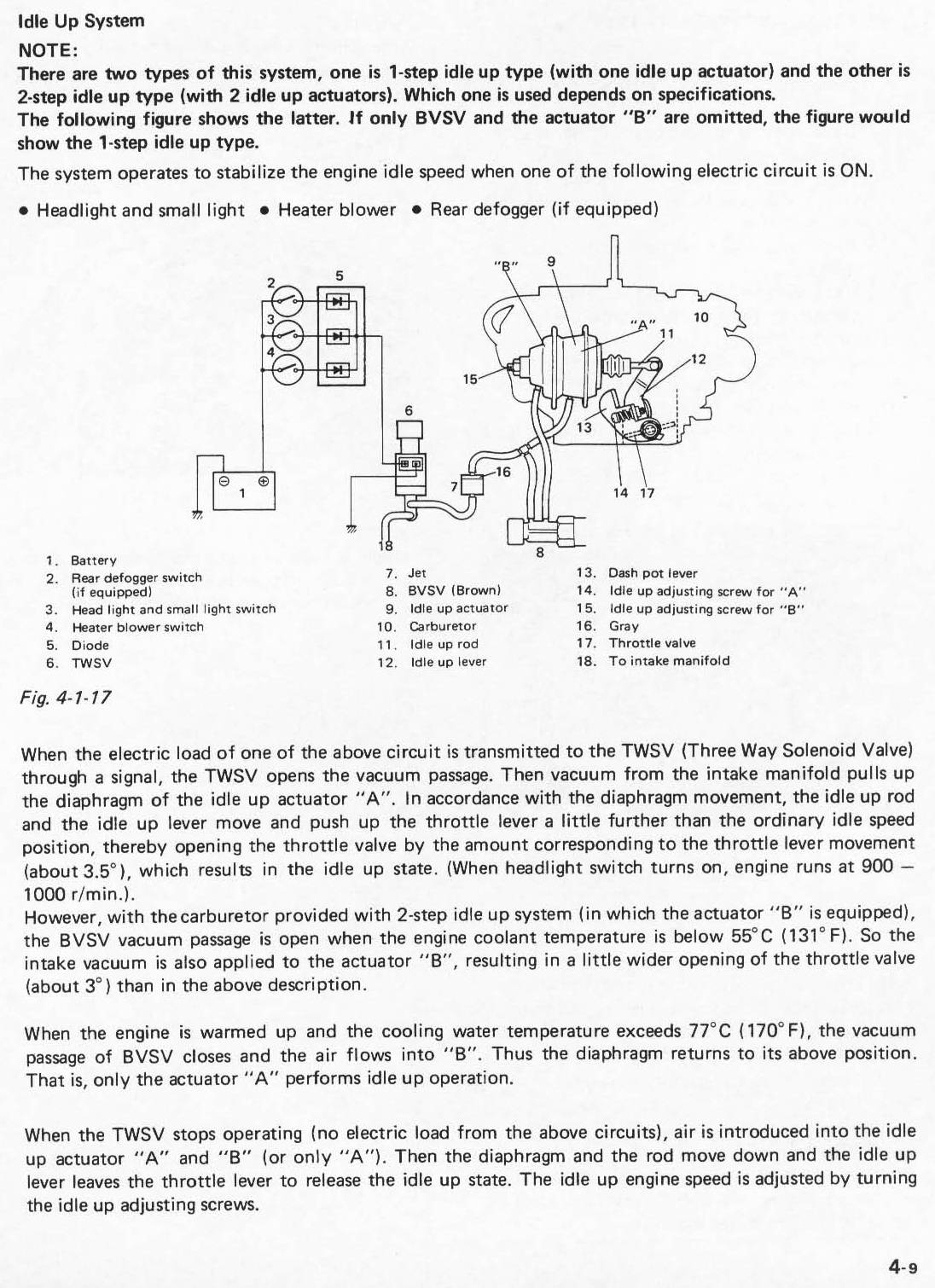

Hi guys just swapped engines on my sj knackered g13B to an ok g13A everything runs as it should,
except when i switch headlights on revs race upto 3000 rpm. any ideas? cheers mike

Sounds like the idle up system needs adjusting.

Needs adjusting.....................or just unplug the bugger.
Idle up SJ 413.jpg (256.4 KiB) Viewed 7742 times

cheers guys "removed the bugger" spot on everthing works. MOT tommrow fingers crissed sorry
