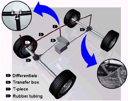

Installation...
Prise off the spring loaded caps on top of both differentials and the transfer case, using an old screwdriver. Now fit a 12.5mm pipe over the breathers. A garden hosepipe works weel for this, or alternatively, you could use any tubing. The transfer box is slightly more difficult as the breather is a slightly different size, but by placing the end of the tubing in boiling water, it will be softened enough to slide it over easily. Secure each breather pipe with a jubilee hose clip. Connect all the pipes together using "T" pieces, so that only one pipe comes forward to the engine bulkhead where it can be secured. As added protection, a fuel filter can be fitted to keep any dirt at bay. When fitting the breather tubes, remember to allow enough excess for the natural movenment of the axles.
