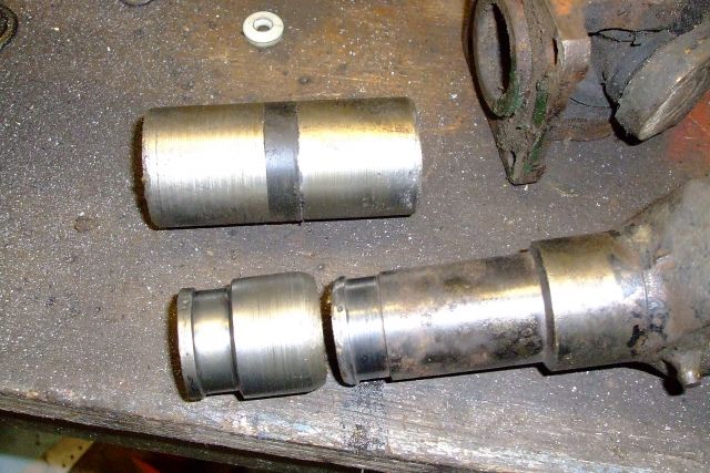

A bit of tube was found that slid over the yoke (Note I'm running Skinny props but the principal is exactly the same.) and then another piece with hacked off a spare prop that I had lying around.
These were squared up in the lathe, this isn't 100% needed but it helps.
Here you can see the extension piece and the bit of thin walled tube.

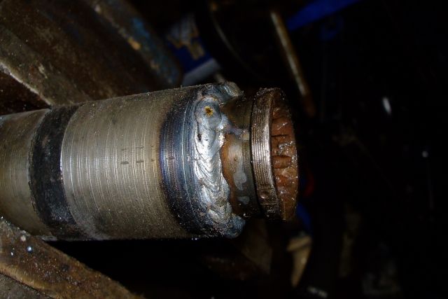

I welded the extension piece on first, (it was slid onto the splines of a prop to make sure it aligned) then the welds were ground back slightly to allow the tube to fit.

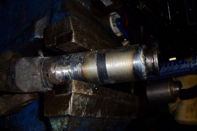

Then the tube was fitted and welded, 1 of the welds had to be ground back for the sake of balance and neatness.
But i think that should hold.
And the finished article. Mental note to put camera on charge!
