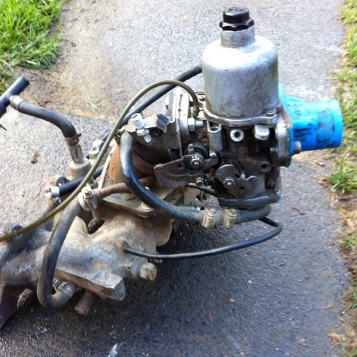

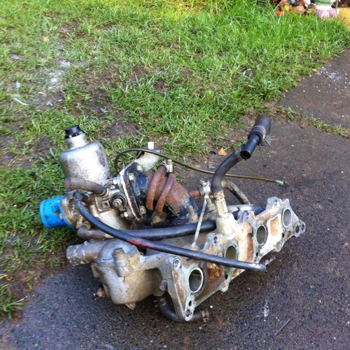

ive picked up a su carb conversion inlet manifold, adaptor plate and the carb but i was just wondering would i get away with using my inlet manifold or do i have to change it
and any other helpfull tips while fitting would be gratefull
cheers jake
Re: fitting a su carb
Post by Jordi » Sat Dec 08, 2012 5:30 pm
Is it a modified manifold to bolt an Su straight onto or does it have the 90* elbow adaptor?
You got a pic of exactly what you've bought?

As it has an adaptor I don't see why you can't use your manifold. Saves you some work.
You just need to fit as it is on the manifold now.
Post by dan_2k_uk » Sat Dec 08, 2012 7:35 pm
To use your existing manifold you will need to cut or file some material to open up the 2 holes to make one oblong hole.
Dan
Post by Jordi » Sat Dec 08, 2012 7:37 pm
As said. Your manifold will have two holes. Needs cutting out into one big whole.
No reason why you cant use your manifold. Or swap the whole lot. Time wise and cost i'd say 6 and 3 2s.
