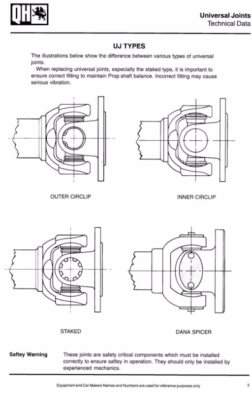

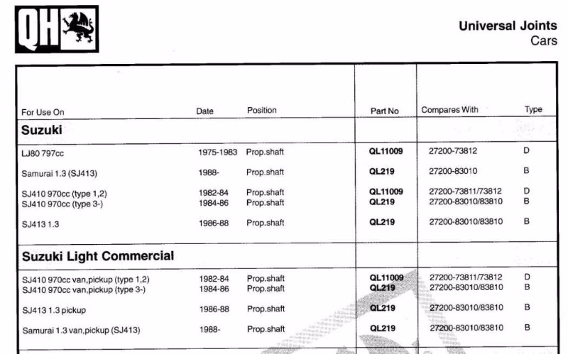

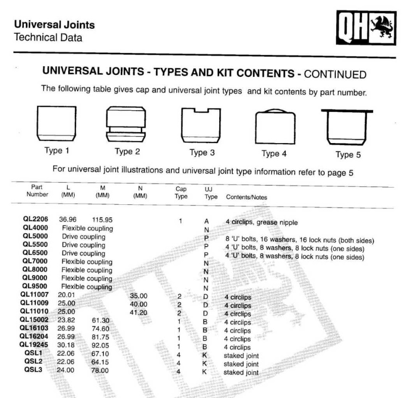

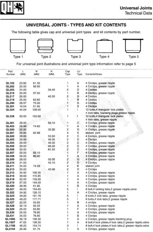

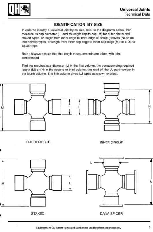

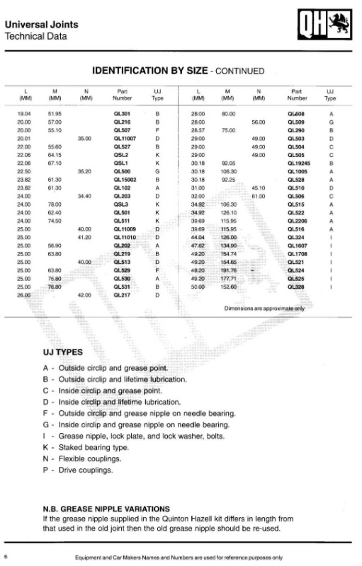

Post by ScottieJ » Thu May 06, 2010 1:03 pm
UJs
84 Onwards Jap built 25.00x63.80
code= PUJ2028
Hardy Spicer greasable UJs HS157
Also found these codes but need to confirm they are correct
TOYO RUJ1783 with external circlips, or RUJ1795 with internal circlips.
KOYO (Suzuki use Koyo) with External circlip is RC1518-CC1A, Internal type is RC1518-RCC

Hi guys,
as I understand ALL UJs ARE THE SAME right? Regardless which shaft?
Guy from part place trying to tell me that UJs on first shaft (trans to tbox) is smaller than the rest, like 24 x something..?
Posts: 11718
Re: UJ Info
Post by ScottieJ » Thu Jan 22, 2015 1:08 pm
It shouldn't be but there are a few late model and aftermarket props around that use a UJ with a 24mm cap.
