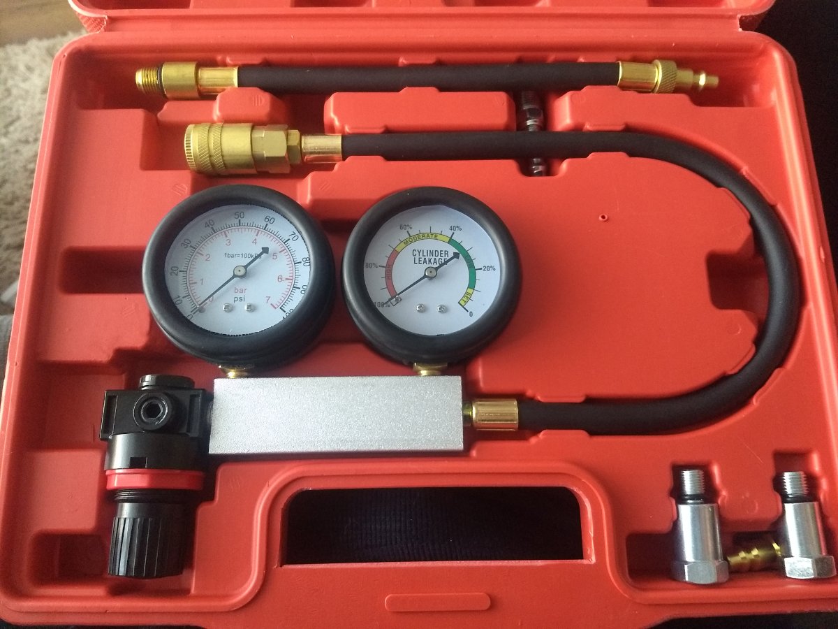

Think I'll buy a leak down kit and try that to see if it's pressurising the coolant.

Good to know, thanks. I've just done the timing belt and fitted a new water pump as well as back flushing the rad. All looked good and when running with the rad cap off you can see that there is flow across the radiator once the thermostat opens. I've just had a delivery of a leak down test kit so will give that a shot asap and let you know if that gives any clues. :salute:

I've just done a leak down test and each cylinder was in between 20 and 30% give or take (I repeated it across all cylinders several times). All reasonable values I think and could hear hissing from dip stick tube mainly which indicates a bit of ring wear, no surprises really.
