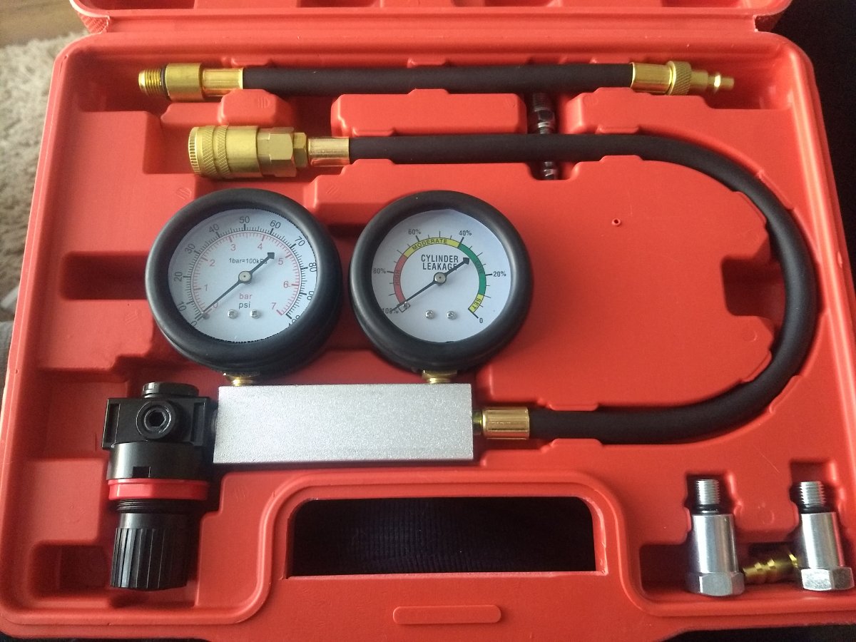

Think I'll buy a leak down kit and try that to see if it's pressurising the coolant.

I've just done a leak down test and each cylinder was in between 20 and 30% give or take (I repeated it across all cylinders several times). All reasonable values I think and could hear hissing from dip stick tube mainly which indicates a bit of ring wear, no surprises really.
