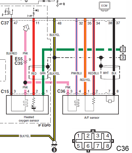

Post by Darrell » Mon Jan 26, 2015 11:37 pm
This is what I could find, so I can't guarantee anything as I have no experience with this model.
Hopefully somebody with access to the Suzuki portal can confirm things.
A-F sensor.png (38.9 KiB) Viewed 11107 times

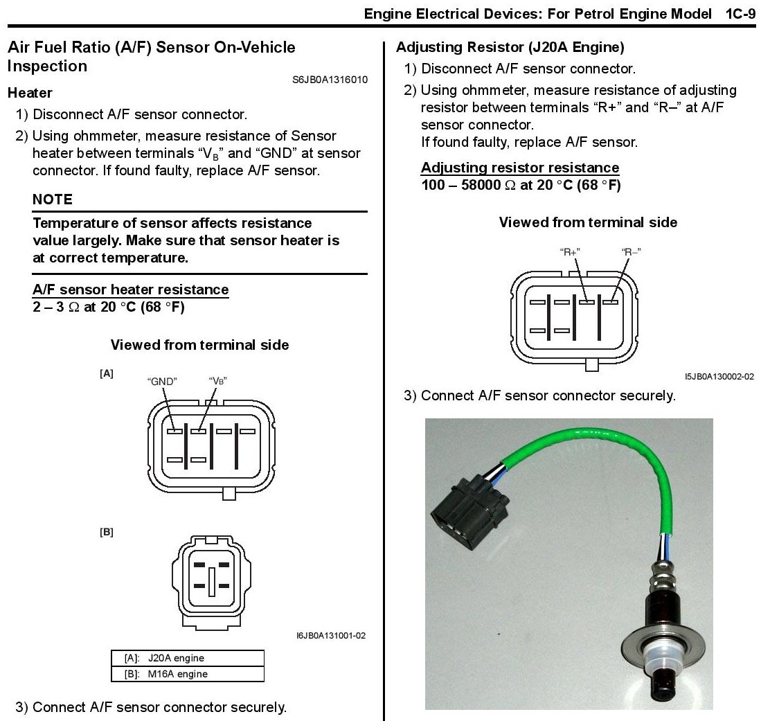

Well, I just measured the resistance and got 1 ohm and 15 ohm. Looks like this sensor is done.

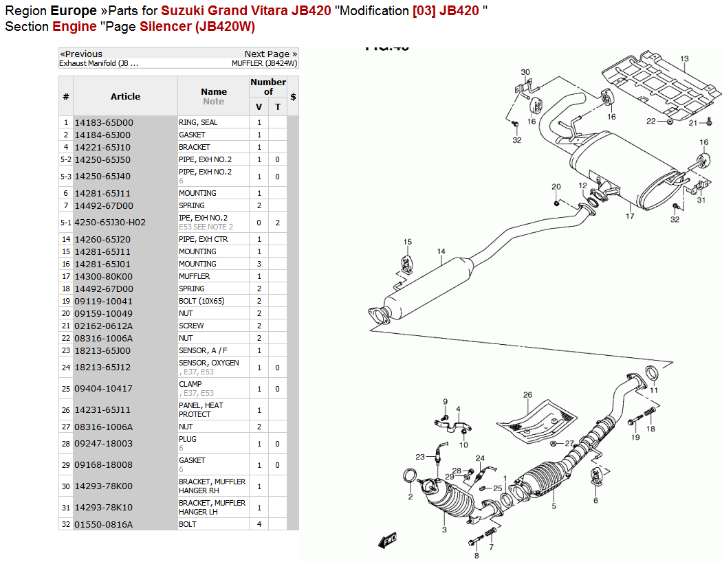

Sorry for the delay, just got the engine opened today and the lambda sensor that was installed was a Denso 65J0 211200-4520. Googling for it, looks like it is not the correct one for my car.
1995 Zuk, that isn't the correct one.
