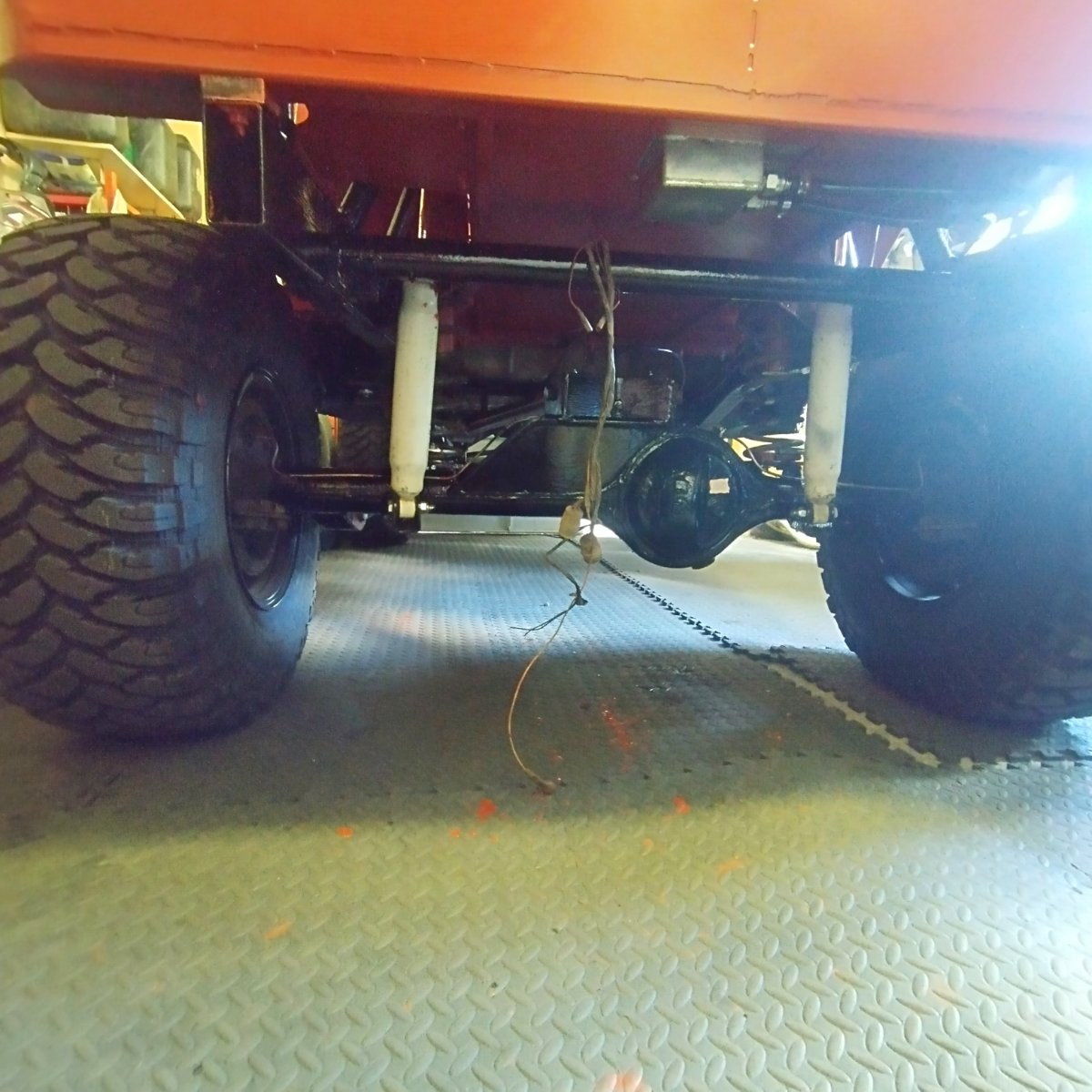

Starting to price back together now. Made some snap fastenings for the roof so it's abit tighter and secure, will do for now. Both seats bolted in now. Rear bumper next to sort, and of course to finish painting, im just fed up of painting for now.

Exhaust not to everyone's taste but struggling to get it out the back with the suspension being in the way. Needs one more mount and then brackets painting. Led side repeaters on and wired. Slowly getting there. Hopefully another update tomorrow too
