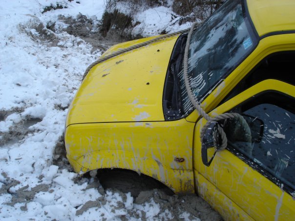

First time out after buying her from Darren @ KAP, mods included 4" spring lift with shocks. very yellow paint job. front bash plate and the prototype of the front bumper replacement. Don't think there was much else.

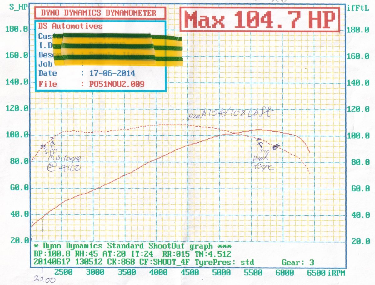

Should have left it, but I didn't, fed it a DTA S60 ECU and while drunk and bought a mini supercharger
bit of post dyno fiddling and she got her MOT . some generall hooligan behaviour and lost of fun,

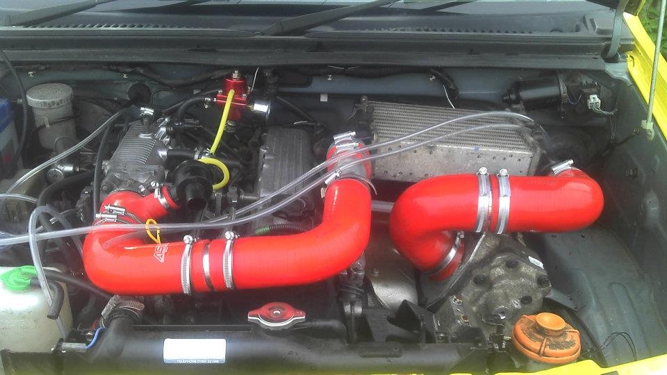

then got her stuck for an hour here, cost me an oil pump, that was more than a second hand M15 engine, so the inevitable happened Changed lump to the M15, back on the rollers, naff all boost above 3k rpm
found all the Teflon off the rotors stuck in the intercooler, rotor casing scored up ..........
new blower off a Merc something, still an M45 Eaton unit, but different configuration.
made a complete mess of getting it working, some really dumb ideas happened, i.e. cable operated recirculatory valve,
