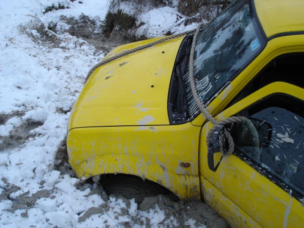

First time out after buying her from Darren @ KAP, mods included 4" spring lift with shocks. very yellow paint job. front bash plate and the prototype of the front bumper replacement. Don't think there was much else.

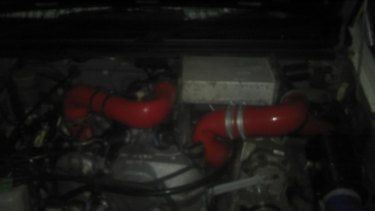

Should have left it, but I didn't, fed it a DTA S60 ECU and while drunk and bought a mini supercharger :S

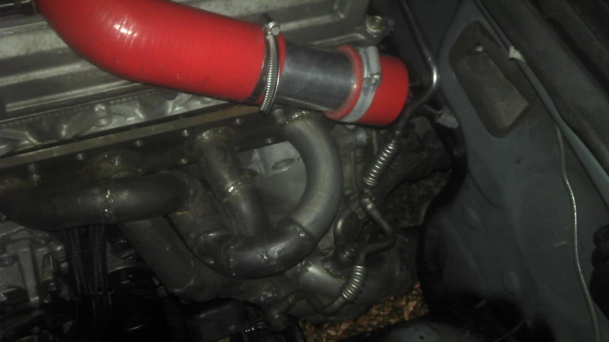

for one reason or another, was not happy with it, so I acquired a M13 VVT lump and started again.

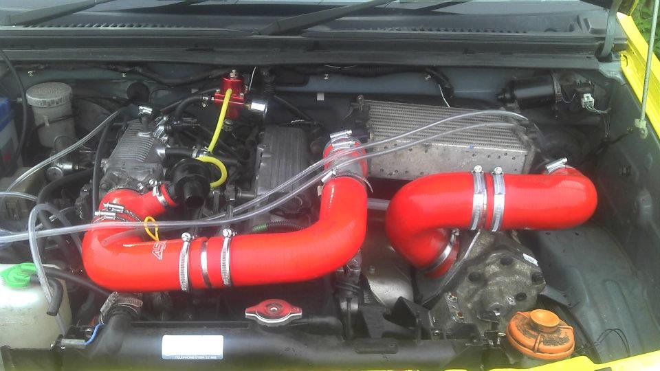

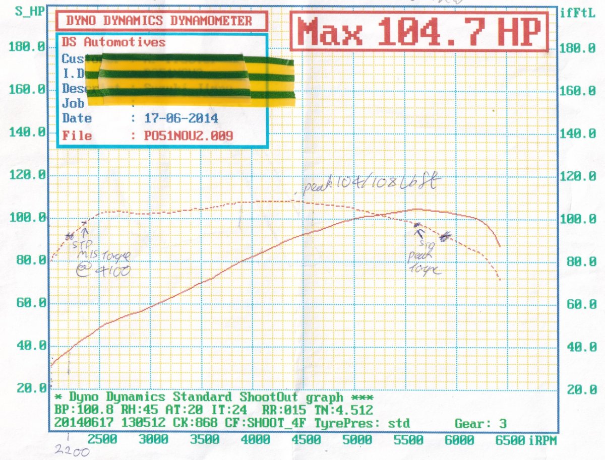

Worked well enough, made decent torque at low rpm even though the peak power numbers are nothing special.
bit of post dyno fiddling and she got her MOT .

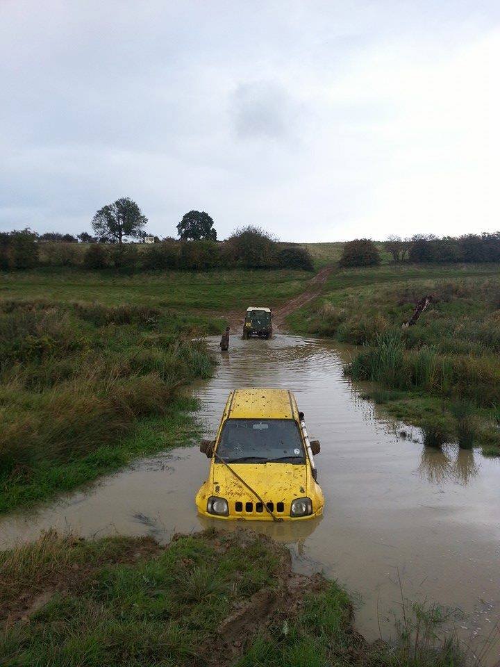

then got her stuck for an hour here, cost me an oil pump, that was more than a second hand M15 engine, so the inevitable happened
