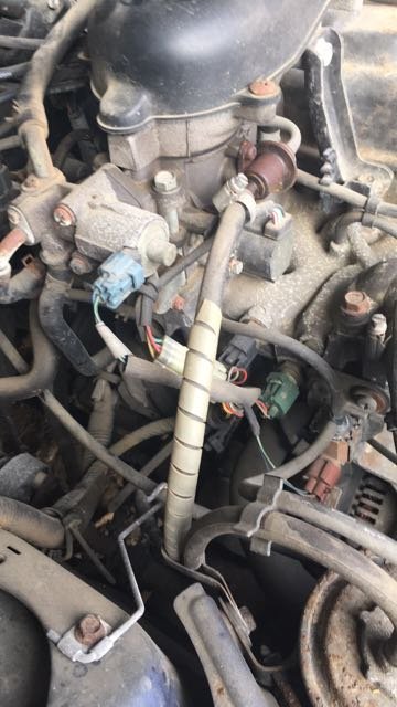

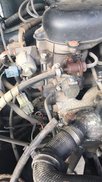

Thinking this is electrical intermittent issue.
Wondered if any one has seen this before.
You can crank the car all day, tow it and it wont start or fire.
Squirt ether in to the inlet manifold and it does not fire. No spark.
Plugs are not getting wet either, no fuel coming in .it will not flood
Seems very much to me like something is not turning on .
Tried two keys, both chipped keys, both work in the past
In the passed this has happened too, and come back the next day and if starts on the first turn of the key.
It was running fine the day before.
Do these motor have some fuel cut off to the ' carb' ( is it a carb or some fancy injection system ?)
had one suggestion of main power relay to the ECU...where would I find that? or does it even exist on these motors?
Totally at a loss with all this electronic shit...never seen a 'carb ' with so many connections on it
Wont start no Fuel or spark - but perfect yesteerday

I believe that by 1999, Suzuki was using the G16B engine with fuel injection. That "carb" is probably actually a throttlebody. As such, if you lost fuel *and* spark at the same time, it's likely to be an ECU issue - but I don't know anything about ECU's. I don't even know if your ECU has an OBD2 port for diagnostics. Rhinoman is most likely to know, he's the ECU guru. Or Darrel, he's the resident wiring diagrams hero.

Yes, did wonder about that throttle body.

I did hear a suggestion that there is a main power relay to the ECU and that can fail..need to either start digging about , find relay box or similar I guess.
Getting a schematic is going to make this easier.

Down under the dash (passenger side I think) mounted next to the ECU there will be two relays, one for the fuel pump (pink wire gives this one away) and one for the ECU, try changing the ECU relay, its a cheap and simple thing to try.
