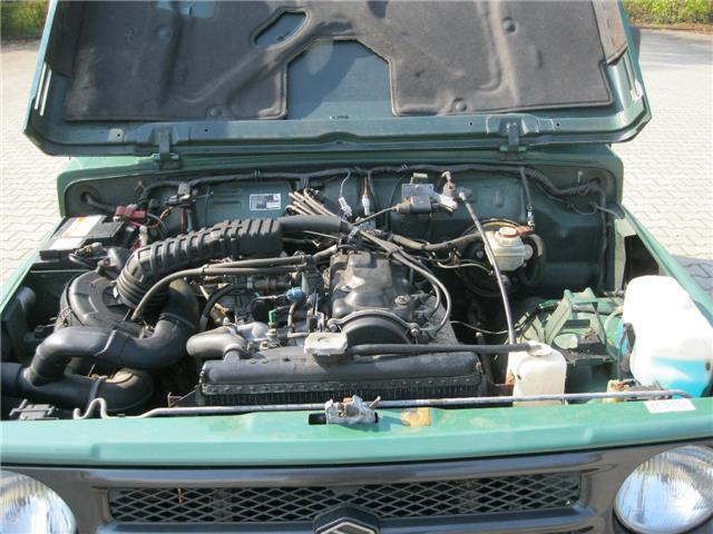

A friend of mine has an Italian Sammy that he's trying to rebuild (he bought it partially stripped), and it's got a coil pack that doesn't seem to be designed for it.
The coil pack:
The HT lead from the coil to the dizzy is too short. Simple enough fix, that. But... The wiring loom doesn't match the The top plug in that photo fits, but the lower one doesn't.
See here: Top connector matches, bottom one doesn't:
Is that connector for something other than the coil? Are we being stupid? I'm housebound at the moment, so I can't go look at it, and I can't check my Zuk to see how mine is wired.
If we have to swap it out, what coil pack do you lovely lot recommend?
