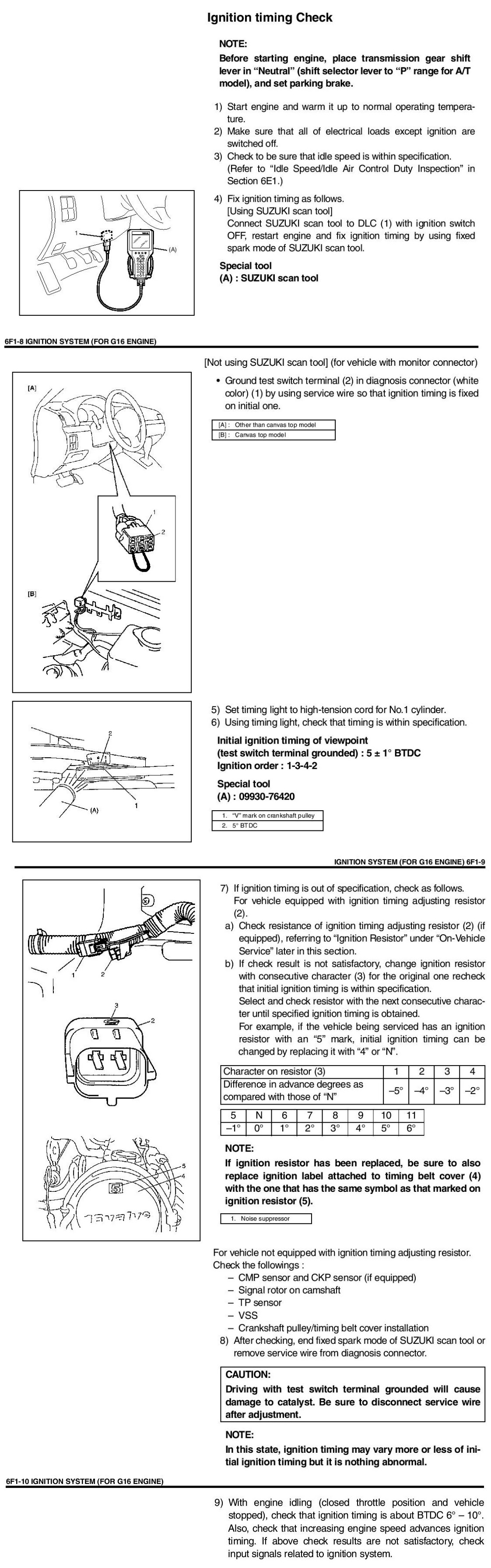

Post by Darrell » Sun Jan 29, 2017 5:06 pm
No dizzy on the GV :thumbup: not that year anyway.
The 5 deg bit is relevant with the test wire in place. Yours sounds fine. I can upload the relevant section if you want to confirm :salute:

Please upload the section. I simply plugged in the OBD scanner. Should i also have used a test wire?

I knew you would want it so had already started pasting together :thumbup:
GV g16 ignition timing.jpeg (786.17 KiB) Viewed 13552 times

Post by Darrell » Sun Jan 29, 2017 5:34 pm
I'll be honest, I don't even know if a UK model has a monitor connector. I've never looked for one on mine.
8 degree looks bang on with out the link wire :doublethumbs:
