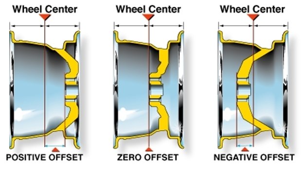

The offset is the position of tyre in relation to the wheel hub surface ?, are all the above ok with this and which/where are the numbers for this to check, how far different can it be?

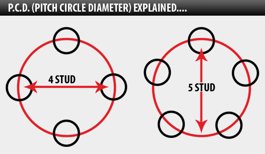

Almost any 5x139.7 pcd wheels will fit. I know Daihatsu, vitara, lada niva and some older jeeps (CJs I think) fit.
SteveR
Posts: 76
Joined: Mon May 27, 2013 9:42 pm
Re: Excuse my ignorance,Steel wheel info and options please
Post by SteveR » Wed Jan 01, 2014 7:03 pm
Thanks jordi,BUT
What the hell does 5x139.7 pcd wheels mean.
steve
Post by Darrell » Wed Jan 01, 2014 7:20 pm
:thumbup:
Post by Jordi » Wed Jan 01, 2014 7:43 pm
Cheers Darrell, my best effort is wheel stud spacing. Diagram shows it just a bit better, lol.

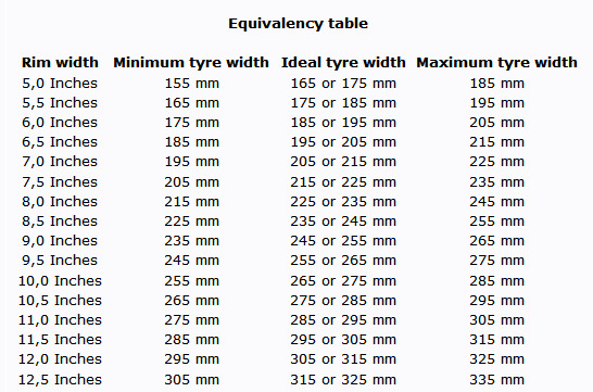

Bit more info
I have no idea what the offsets are as standard :oops:
Tyre-size-for-rim-width-The-Brick-yard 2014-01-01 19-44-08.jpeg (124.47 KiB) Viewed 6409 times

I don't know the offset but the stock backspacing for an SJ is 95mm.
