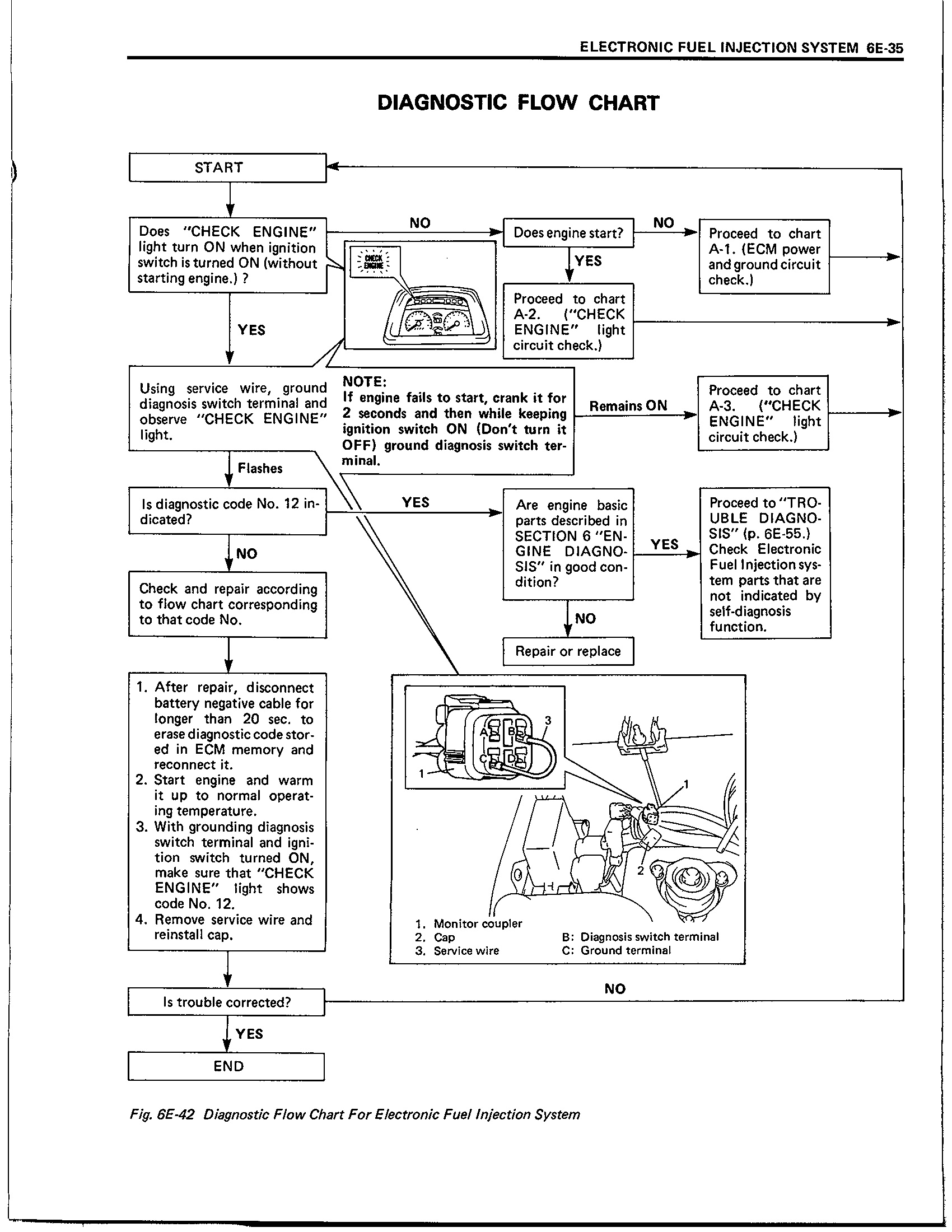

I'm not sure if that year can be checked using the service wire method.
Hopefully "Rhinoman" will spot this as he's the ecu/injection/electronics expert

There isn't any OBD2 on a Vit, EOBD wasn't mandated here until 2001. You can use the jumper method to pull codes but the flashing light is an immo problem. Have you jump started it lately? if you don't do that properly then you can spike the immo and corrupt the memory - that's usually the cause of the problem.
The connector for the codes should be a six-pin connector next to the driver's side headlight, it should have a rubber boot over it.
You can't swap ECUs as they are matched to the immo, the key is also matched to the immo.
