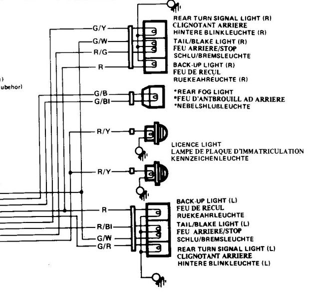

ok i looked at the wiring diagram but i am blind and cant seem to zoom in. i have 3 wires coming out of my brakelight and 2 out of the indicator but i only have 4 wires coming out of the cars loom 2 gree and 2 red can someone please help as i am very confused as to what to wire to what thanks in advanc e
Re: landy rear lights help
Post by Darrell » Sat Nov 23, 2013 5:36 pm
3 of them should have a tracer colour..

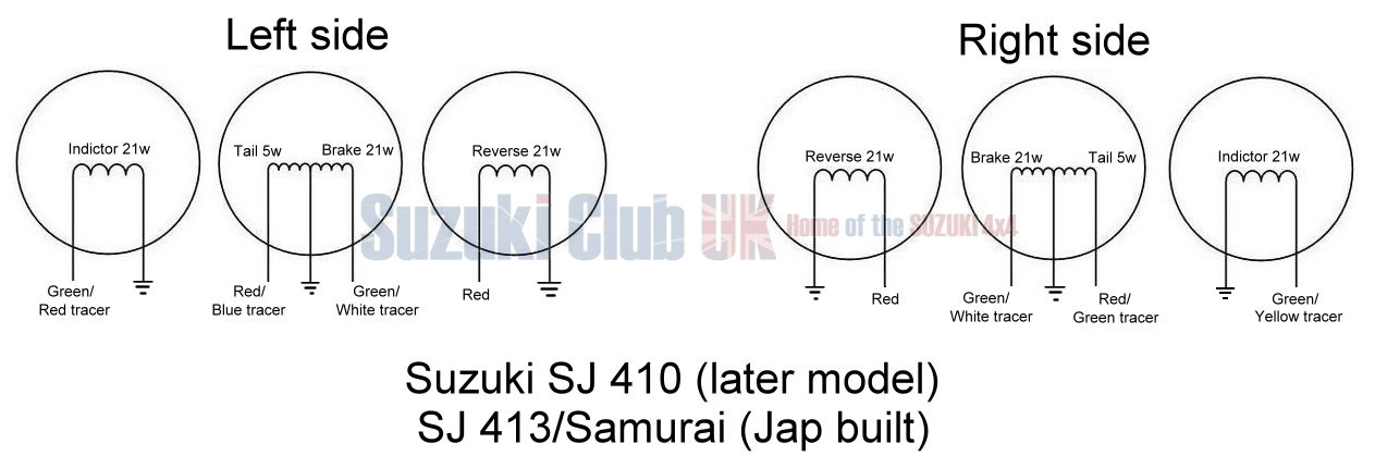

thats a great helpthansk as i read it i connect one indicator wire to gree/yellow and the other to earth. and 2 wires for the brake lights and the other to the earth. i bloody hate wiring
Post by Darrell » Sat Nov 23, 2013 10:30 pm
I haven't done a diagram for ages ..... so
