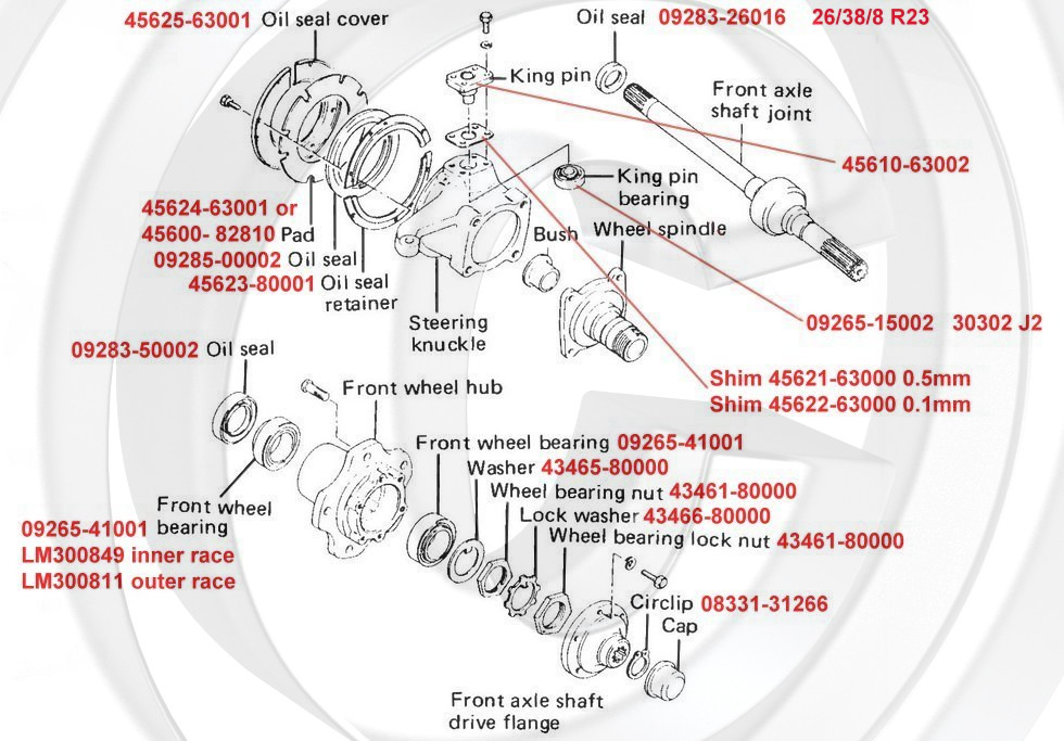

The wheel bearings are easy enough to change, but you could do with a big socket (50mm) if you can borrow one.
A couple of tab washers may be useful if you have a Suzuki dealer nearby (you can often reuse the old ones).
If you buy a kit it will also come with a hub oil seal.
I would pull it apart first before buying any parts though, just to see what you need.
Front Hub Numbers.jpg (174.16 KiB) Viewed 6447 times
If you have freewheel hubs disengage it and give the wheel a spin.
If you have fixed hubs, remove the axle shaft drive flange and give the wheel a spin.
If it's still tight at least you know its the wheel bearing and not the diff or UJ's tight.

As Darrell says, you will need a 50mm socket which in my experience may have to be modified to provide a longer length - they always seem to be too short to allow it to engage with the outer locking nut which MUST be correctly torque loaded. Expect to pay about about £6-7 pounds for one from a tool seller from a market etc.
You really have to do this job properly for it to be successful - avoid shortcuts e.g. whacking the locking nuts tight with a hammer and punch, if you do, expect to replace the bearings 1000 miles later.
