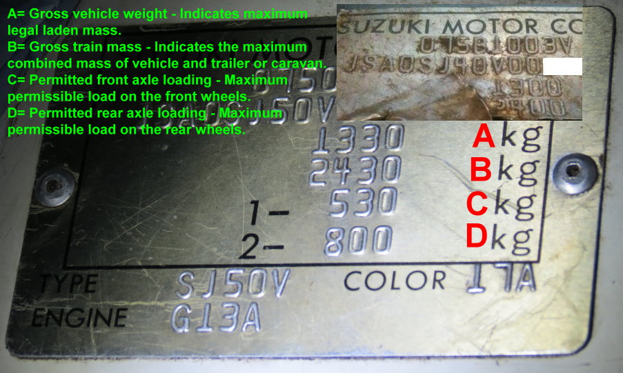

im ordering a new vin plate for the zuk and my old one has 1300, im guessing is gross weight of the car and then it has 2400, is this the maximum train weight of the zuk?
