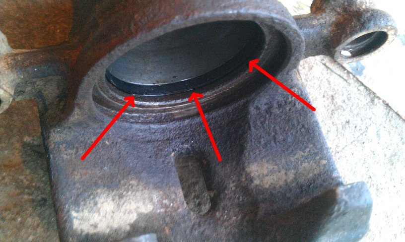

Here is a pic of the retaining spring I prusome it goes in the dust seal and how do u get it in the caliper then as I have tried but it no luck

Re: i may need help to rebuild asian calipers
Fit the narrow end of the boot to the piston. Then fit the other end of the boot to the caliper while the piston is still loose.
Once the seal is seated in the caliper push the piston in about halfway. Then get the spring clip and fit one end into the seal and very carefully using a small screw driver feed the clip in all the way round.
If it's not too late I would also use some wet&dry paper to remove this rust as it may be scuffing against the piston.
Obviously remove the seal first and give it a good clean afterwards.
