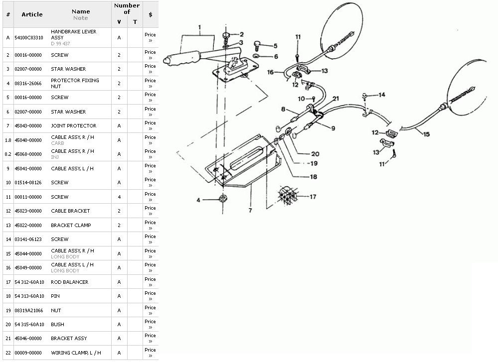

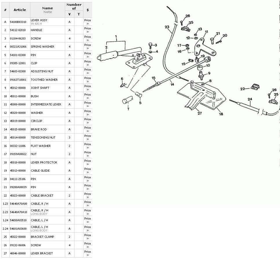

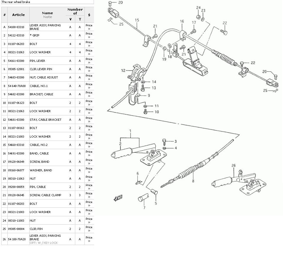

I think the one I have spare is number 23 on the second diagram.

No I still havnt got one.the one thats broke on mine is number 8 on the 3rd diagram.
But I think I may be able to make those cables fit to the bracket attached to the handbrake lever.
I will have a look after work tomorrow and get back to you.
Thanks for the responses, those diagrams are really helpful.

My samurai is number 3 diagram, when my cable snapped. I went to my local motorfactors, I could not get a drivers side cable, but the passenger side cable was available, I bought x2 passenger side (to replace both the cables) I had to swap the fitting (number 14) over to make it drivers side, it was the only difference between drivers & passenger. jobs a fish
