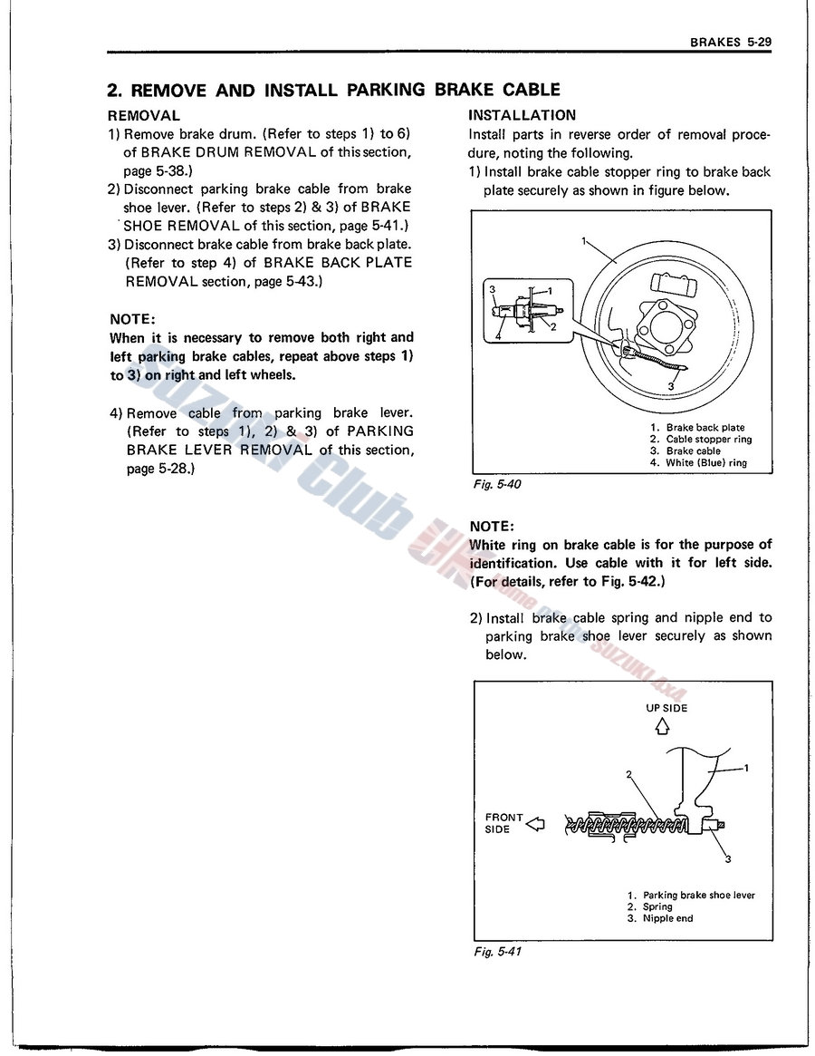

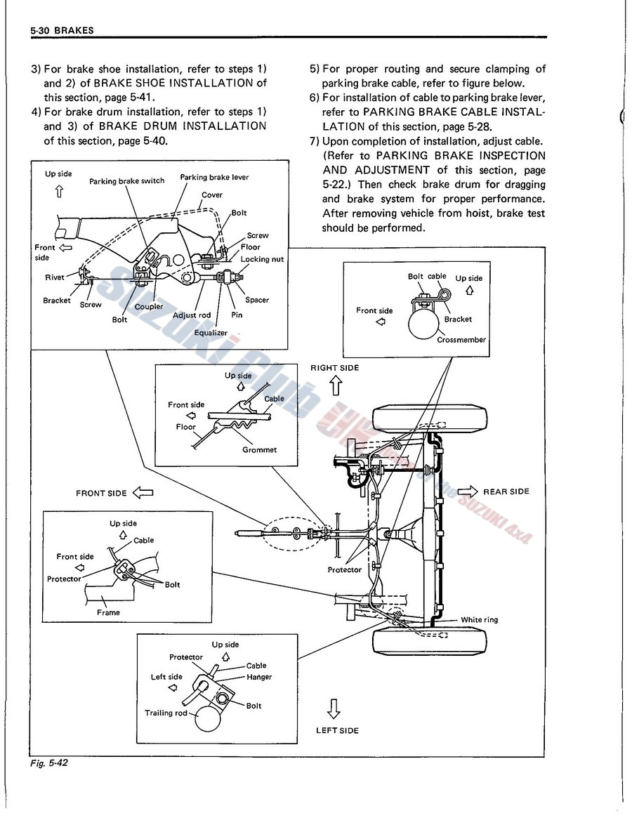

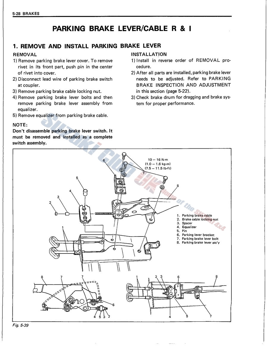

Hi, I have bought new handbrake cables for my Vitara, as one has snapped off, and the other one is ok, but may as well be done as well. Is it easy to do, or worth taking to a garage to get it done? Cheers, Joe.

Post by Darrell » Mon Apr 08, 2013 11:34 pm
:suzuki:
vit cable 3.jpg (192.38 KiB) Viewed 3945 times
vit cable 2.jpg (169.92 KiB) Viewed 3945 times
vit cable 1.jpg (184.56 KiB) Viewed 3945 times
