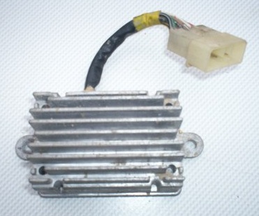

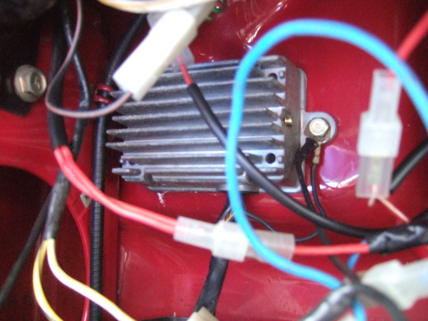

Post by Darrell » Sun Mar 17, 2013 5:51 pm
There is no relay as standard, however some models did have a dip-dim unit, which is fitted to the passenger side footwell. I've not heard of them stopping the lights working but they do regularly screw up. If you have one unplug it and let us know what happens :thumbup:
looks like this, if you have one!
