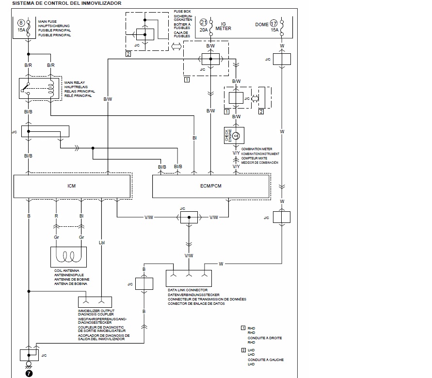

- Jordi
- Posts: 7540
Re: no key
Re: no key
Damed if I know what's going on.
Antenna get signal and --------------------- I dunno
No help whatsoever, but any excuse for a diagram.
- immobiliser circuit.jpg (113.13 KiB) Viewed 9201 times
- Jordi
- Posts: 7540
Re: no key
Superb. I like a good electrical diagram. I got one off the chap i bought my zuk off.
