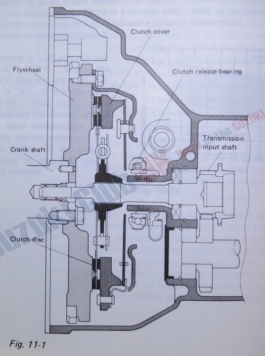

Post by Darrell » Sun Nov 11, 2012 11:58 pm

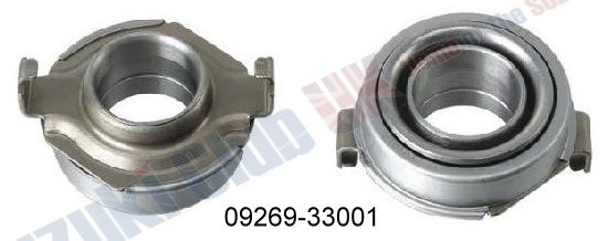

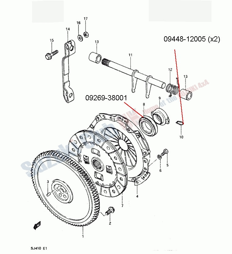

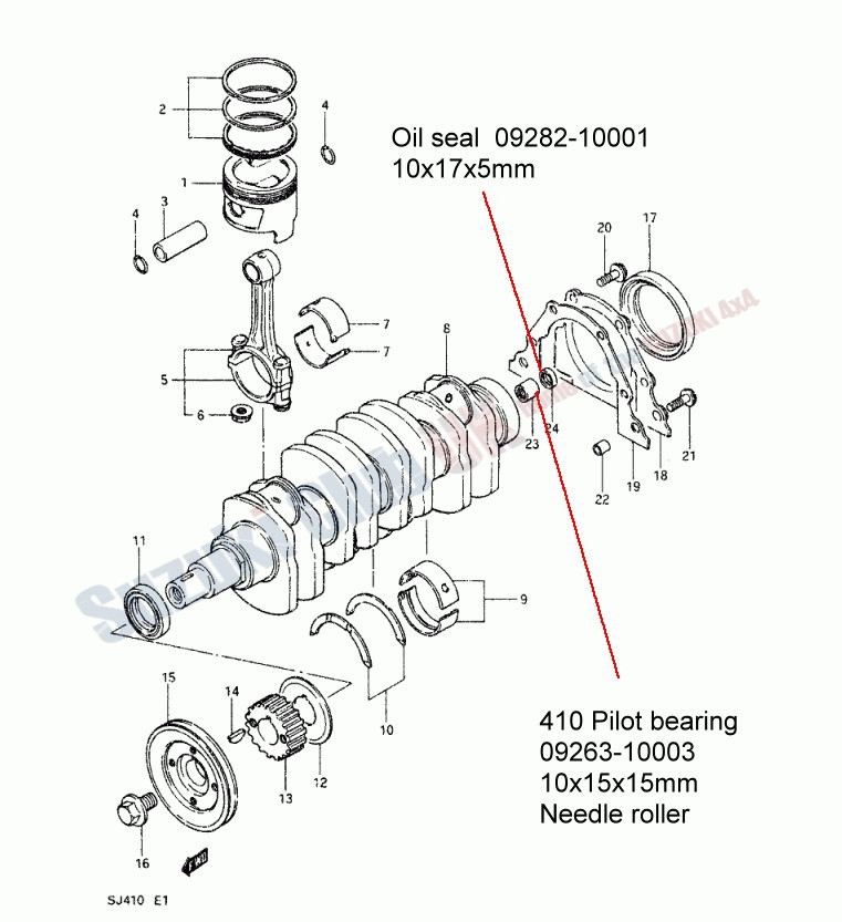

Early SJ410
Early 410 clutch.jpg (171.59 KiB) Viewed 4667 times
Early 410 pilot bearing in crankshaft (2).jpg (161.83 KiB) Viewed 4667 times
Early 410 clutch bearing.jpg (154.79 KiB) Viewed 4667 times

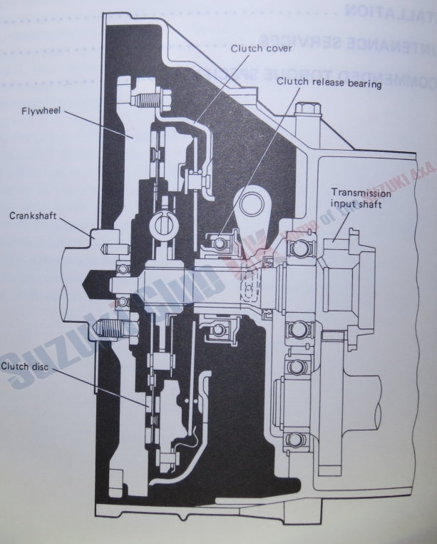

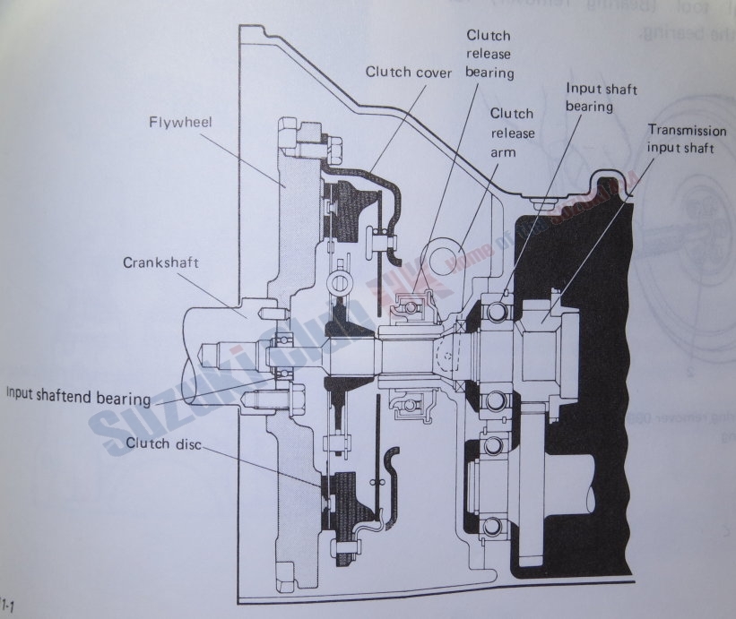

Re: Clutch bearing Info
Post by Darrell » Mon Nov 12, 2012 12:00 am

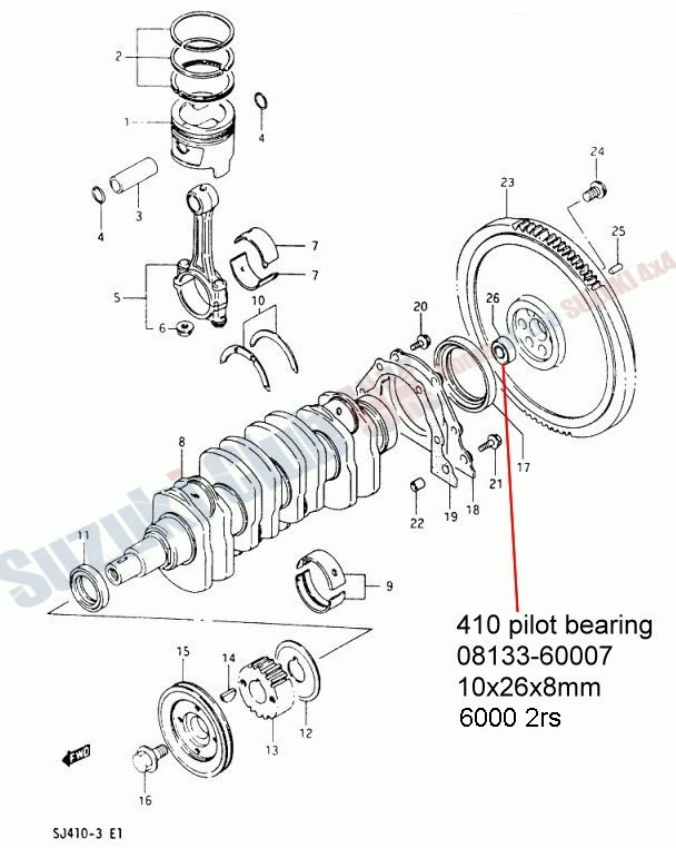

Later SJ410
Later 410 clutch.jpg (212.18 KiB) Viewed 4666 times
Later 410 pilot bearing in flywheel.jpg (136.84 KiB) Viewed 4666 times
Later 410 & 413 clutch bearing.jpg (119.9 KiB) Viewed 4666 times

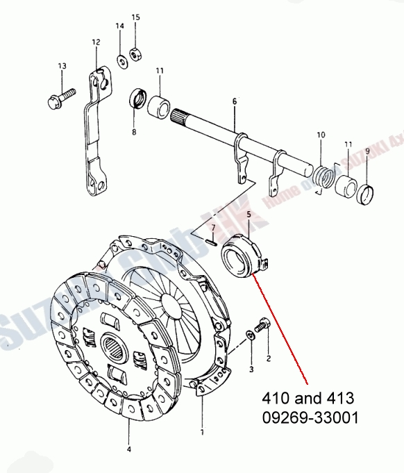

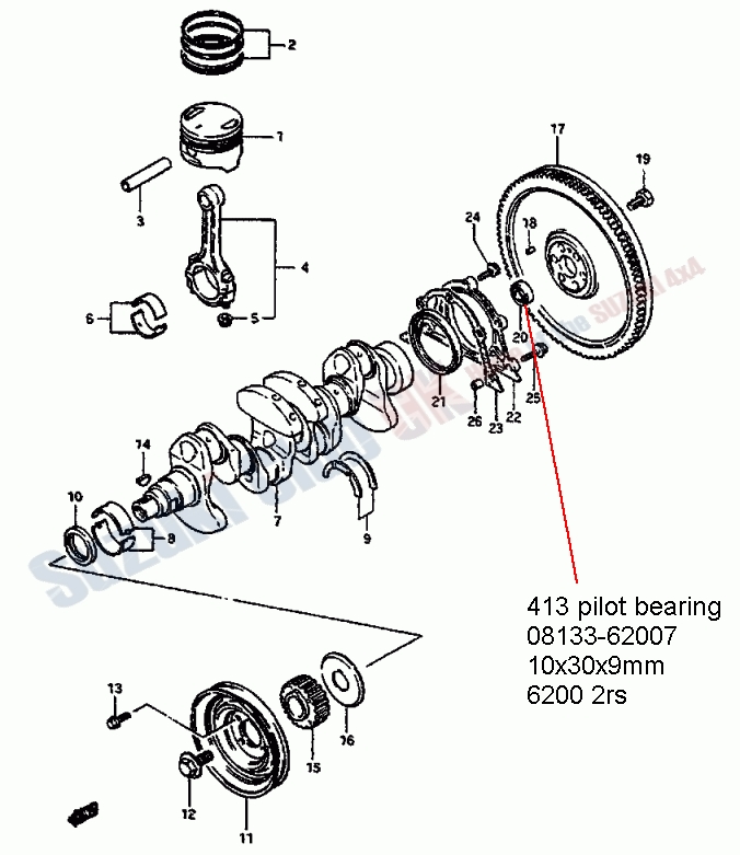

Post by Darrell » Mon Nov 12, 2012 12:01 am
SJ413-Sammie
413 clutch.jpg (191.38 KiB) Viewed 4665 times
413 Pilot bearing.jpg (151.75 KiB) Viewed 4665 times
Later 410 & 413 clutch bearing.jpg (119.9 KiB) Viewed 4665 times

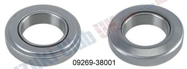

Post by Darrell » Tue Nov 13, 2012 8:29 pm

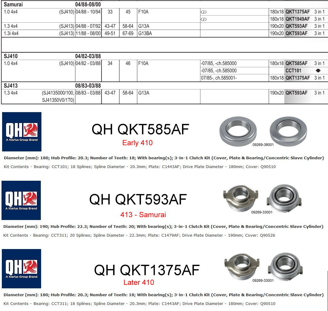

Bit more --
Suzuki SJ clutches.jpg (201.85 KiB) Viewed 4617 times
