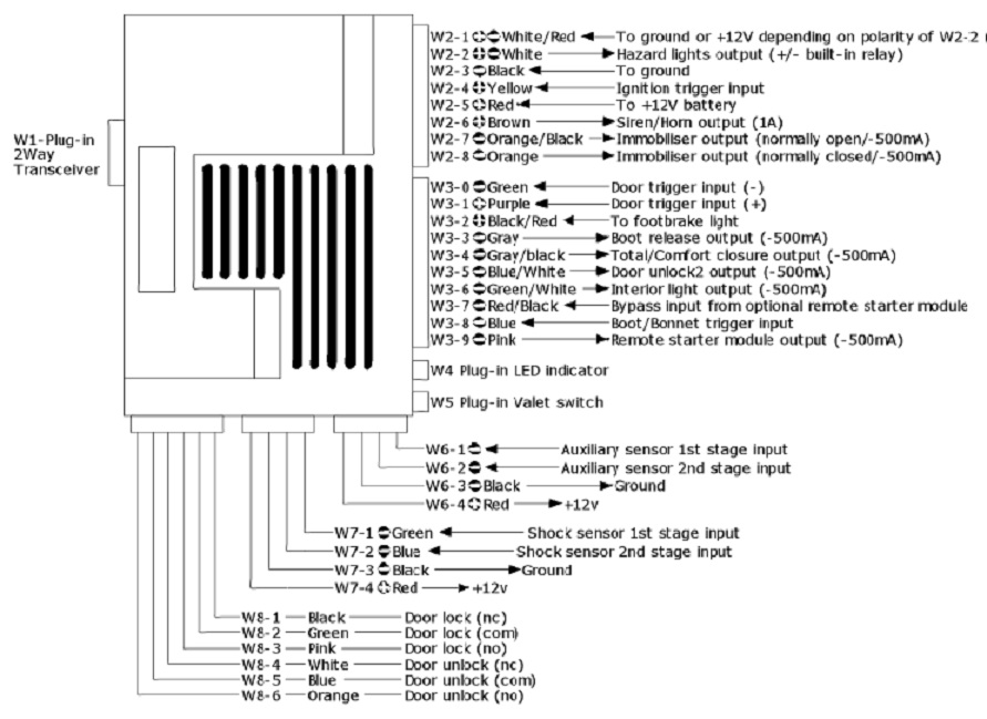

so im fitting an immobiliser and need a diagram for the ignition switch/barrel so i can have the immobiliser switch the start wire via a relay...
or would it be easier to switch the solenoid?
and i cant switch the fuel pump considering its mechanical lol...

How many circuits is it immobilizing, normally it's 2. The coil supply and the wire to starter solenoid.

well it only comes with one relay so i think ill be doing just the coil supply..
and if anyone knows the wiring for the hazard switch then i can do the hazard light feature for when i use the remote central locking..

I would just break into the positive supply to the coil (black/white wire)

do you know the colour of the hazard light switch wire i need to use?

I'm afraid to say that no single wire will make the hazard lights work. Well not that I can see.

:help: Could you post up the wiring instructions. :thumbup:
Re: wiring diagram for the ignition barrell?
Posted: Fri Sep 21, 2012 11:28 am
by Jay18
the instructions are not the best but here they are..
http://www.sniperautomotive.com/support ... Manual.pdf
cant i just wire into the hazard switch?

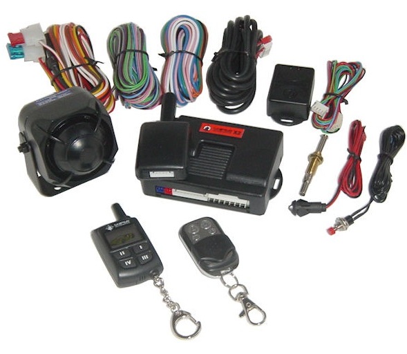

Am I right in thinking you have all this
sniper x2.jpg (73.99 KiB) Viewed 20602 times
But you only want to use the immobilizer ??
