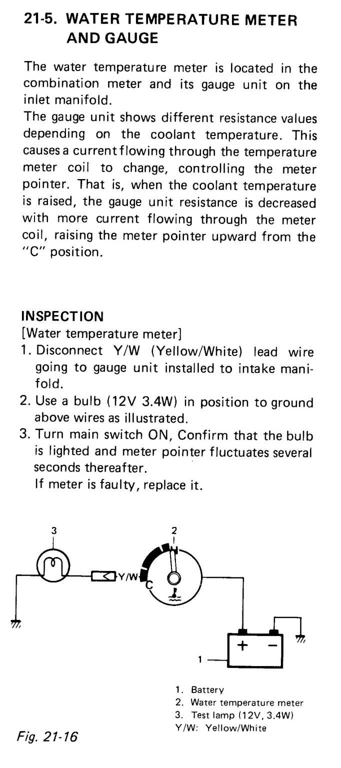

Post by Darrell » Sun Jul 29, 2012 8:59 pm
The basic test procedure with a light bulb will let you know what's going on. If the lightbulb comes on/glows you know there is power to the gauge and that the gauge coil is not broken. The gauge needle should also move. This indicates that the sender is not working.
If the light does not come on/glow then there is no power to the gauge or the gauge coil is open circuit (broken). This needs checking with a multimeter then to see if power is getting to the gauge in the first place. The gauge can also be tested with the meter to see if the coil winding is still there. I have no idea what resistance the multimeter would read but basically if you get a resistance the coil is still intact.
Sender a.jpg (89.73 KiB) Viewed 4597 times
