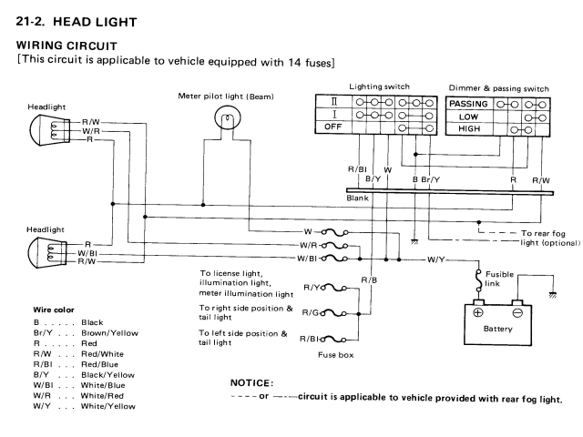

Circuit diagram just in case you have to get the multimeter out.........
Headlamp Circuit.jpg (120.99 KiB) Viewed 17007 times

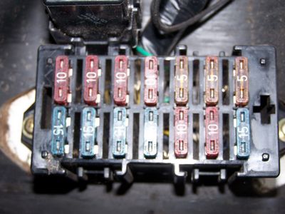

Whipped the fusebox off today and theres definately some "burning" going on, as you can here.....Is this where and what you were referring to earlier?

Well I have heard of some of the fuse board burning up/out, but yours looks just the same as Tramp describes. Poor connection between the fuse board and the push on connection block. Poor connection creates resistance which creates heat and as you can see that's got blooming hot. :shock:
I must admit your fusebox is not the same as mine (Jap). Is yours a Spanish build ?.

Jap fusebox
Jap fusebox
fusebox 2.jpg (26.64 KiB) Viewed 16902 times

Very different indeed! Its a '92 Samurai so im guessing it is...
Hmmm, is this likely to be the cause of the headlight failure?

Post by Tramp » Sun Jun 24, 2012 7:39 pm
Yes!
Mine was exactly the same in the same place! instead of them not working mine became lazy, not starting up straight away but after a few seconds until they stopped working alltogether. I cleaned up the connection using fine emery, built up the pcb with a bit of solder and seperated the crimp from the plug and cleaned it using more fine emery paper, I then put the original size bulbs back in and it worked....
Yes your fuse box is the standard Spanish one the same as my 92 sammy
P.s I had a look for photos but difflocks genocide of images last year appears to have earased mine including my pics of the switchgear clean up
P.p.s you could probably get away with just cleaning up the plug and the pcb board, I went a little over the top when I did mine
