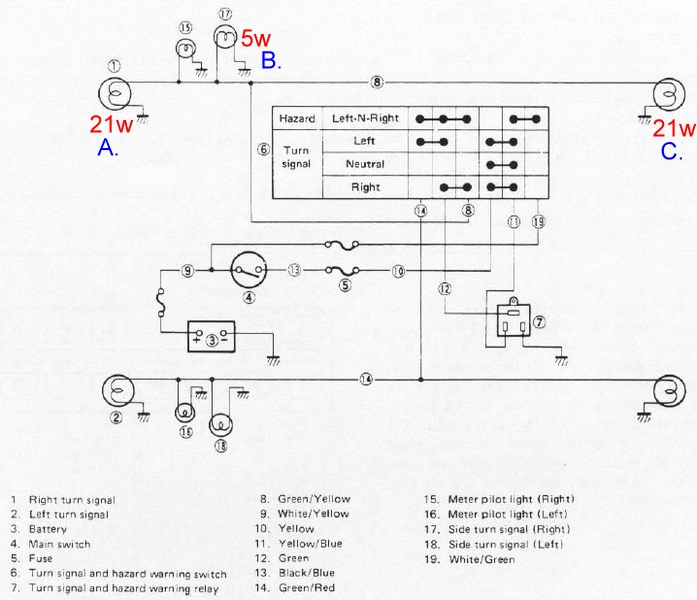

Just thought i would pick your brains, I wire in sum new indicators the other day there off a pajaro anus. think the bulb is 5w its the small push fit style like on side lights on sum cars. The problem is now all my indicators are flashing too quickly. Would some sort of resistor be needed to slow them down like what people use on bikes when fitting LED lights, or do you guys think it could be some think else at fault. Any input would be appreciated. Thanks Andy
Re: Problems
Post by Darrell » Wed May 02, 2012 6:56 pm
I think your right that it may need a resistor. What wattage have you got now for A-B-C.

Post by dunnin21 » Wed May 02, 2012 7:08 pm
instead of 21w i have a 5w. so total of 31w. not sure how it work or what resistor i would need

Post by Highlander » Wed May 02, 2012 7:26 pm
Change the indicator relay for a lower spec one

Post by Tramp » Wed May 02, 2012 7:48 pm
Just put a 21w bulb In the pajero lights
Re: Problems
Post by Darrell » Wed May 02, 2012 7:52 pm
Tramp wrote:Just put a 21w bulb In the pajero lights
Easiest fix if you can :thumbup:
Not sure a 5w front indicator would pass a MOT anyway :er:

Post by dunnin21 » Thu May 03, 2012 6:36 pm
quick update, I wired in the resistor and it work a treat thanks for help
