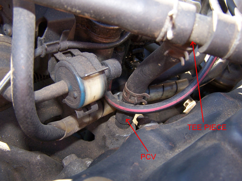

the pipe with the T piece should go from the rocker to the airbox and then the T should go to the PCV valve on the inlet manifold.
The oil is proabably related to that if it's not connected to the PCV valve
as for the engine mount they are £40+ from suzuki but I have some spares if you need one, you can have it for £39.99 ;) nah make me an offer :lol:
just found this image and as it happens their pcv valve was blocked off

Just make sure the pcv valve is working, pop it out and give it a shake it should rattle, if not give it a soak in some petrol to clean it, and no it is needed so should be connected up.

The pcv valve is on the inlet manifold not the carb.

this is my modified manifold but shows where the PCV valve should be screwed in.
