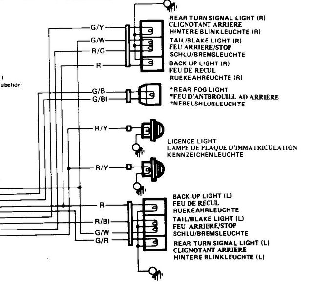

- Rear wiring.jpg (70.67 KiB) Viewed 9813 times

Yer i was thinking about the rear door option but i like to have my spare wheel on the back and therefor doesnt leave any room to mount the right hand cluster :( i may remove it and see what i can do. thanks for the sugestion do these lights on the website come pre wired ?
Re: Rear Light Cluster Replacement Ideas
I don't know, but I wouldn't think so.do these lights on the website come pre wired ?

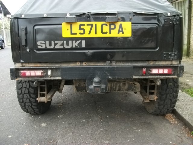

I have a nofearzuks (ebay) rear bumper... with forklift LED light clusters... work bloody well, but those clusters are £65 each!
You can get much cheaper LED light clusters though... more like £20-35 each

Scroll to the bottom of the page to see my lights after i had repaired them
