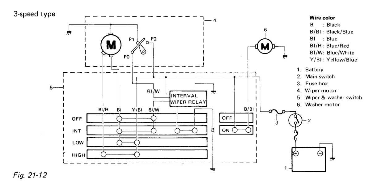

Time for the multimeter!!
Wipers 3 speed.jpg (56.59 KiB) Viewed 4335 times
