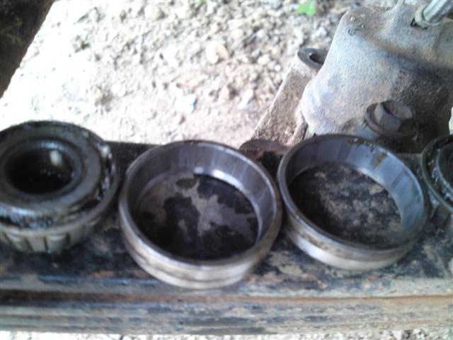

just stripped the n/s front hub and....
apart from some rotaional knotchyness in the king-pins found nothing.
wheel bearings exellent.
king -pin bearings i will change any way..
so clean re-grease reassembl..
tony :P

king pin bearings,(top has small run marks)
Picture 051 (Small).jpg (63.49 KiB) Viewed 4385 times
