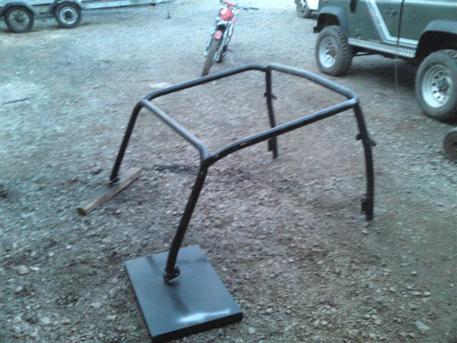

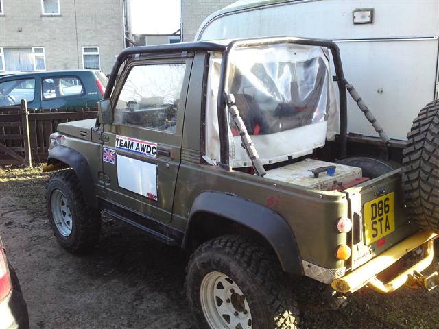

just a couple of pics of the cage fitted.
i's not finished yet,(later in the week)

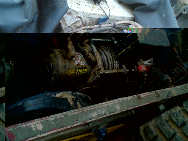

i striped me warn winch down today at work.
motor bearings shot....
brake stuck on...
drum plastic thrust washer missing....

looks good tony, is the front just bolted to the scuttle or is there tube running down to the chassis on the other side of it?
I might have to call you up to help me with my cage, looks like your pretty handy with a pipe bender!

hi scott.
the front legs are bolted to the scuttle,then there is a short length of tube wich goes down to the chassis rail.(effectivly sandwitching the scuttle).
the rear legs land on the inner arches then again a short length will go down to the chassis.
then a diaginal (door bar) will go from the back leg to the front support leg tying it together.
ive not decided on the rear yet but will be simple as i only have enough tube to do it once :shock: .
then a "v" or cross on the roof.and a cross in the rear hoop.
hopefully it shold all stay bolt on.

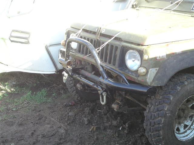

the old front bar has gone to make way for a winch bumper....
( its only half done i needed to fit it to get the correct angle for the winch)
also still undecided whether to go with the warn m8000 i have or just get another t-max like the one in the back,only prob with the t-max is they are a tad heavy nearly 15kg heavier than the warn.
so can i afford the extra weight or do i just buy a new superwinch 10000lb....
tony :P

front bumper
front bumper
Picture 022 (Small).jpg (62.29 KiB) Viewed 9104 times

just looked at those pics.
i really need to cut 6" off each end...
tony :P
yes it willbe painted yellow when finnished.
before you ask its the chassis thats twisted not a wonky bumper.. :shock:

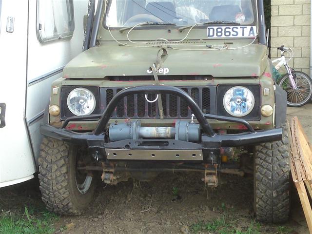

gone a bit slow..so.
remade the front winch mount and give it a trial fit.
(this is a scrap warn m8000 i use for sizing up...if you were wondering)
