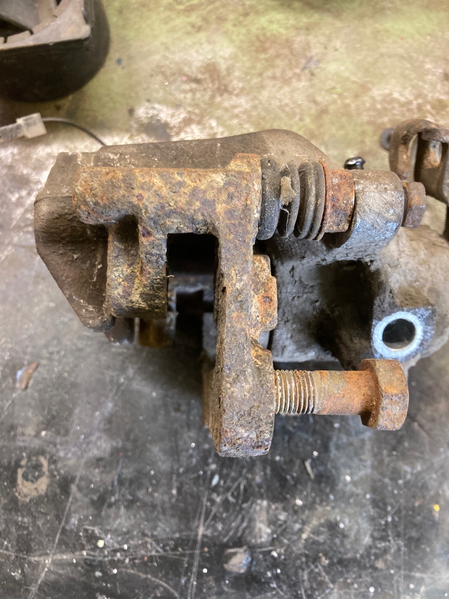

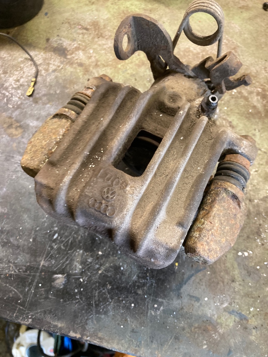

So I’m going to look into this a bit more but while working on my Audi A4 the other day I was fitting new rear callipers noticed the ones I took off were Lucas.
Grabbed a Spanish SJ calliper carrier and sure enough the calliper bolts straight up to the sliders :brows:
When I get a chance I’m going to have a go at fitting some to the rear of the LWB, work out what pads to use (hopefully stock Spanish sj) and work out a cable set up for the handbrake etc.
