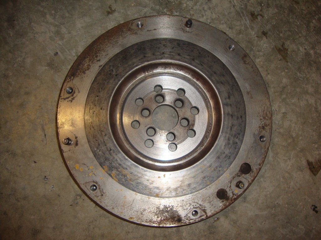

So I've pulled out the laptop to find pics to explain the flywheel differences, I do not have one from a GV1600.

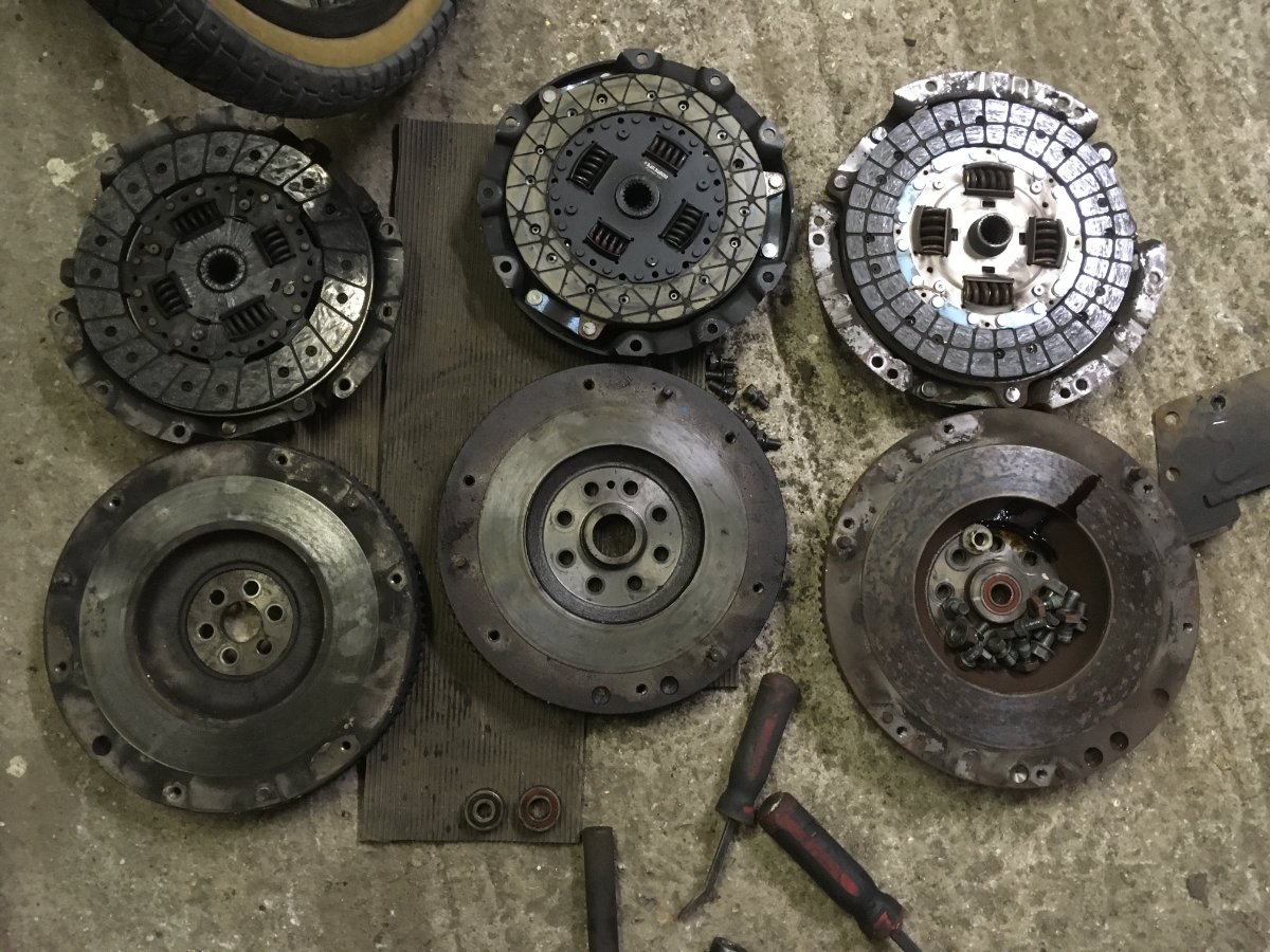

left G16 (cable clutch) middle j18 baleno, right J20 GV (hydraulic clutch)
The Baleno j18 flywheel is the same diameter and thickness as the g16 flywheel but as you can see it also has the protruding spigot bearing holder, I have a feeling that was part of the issue i ran into :er: this was a while back.

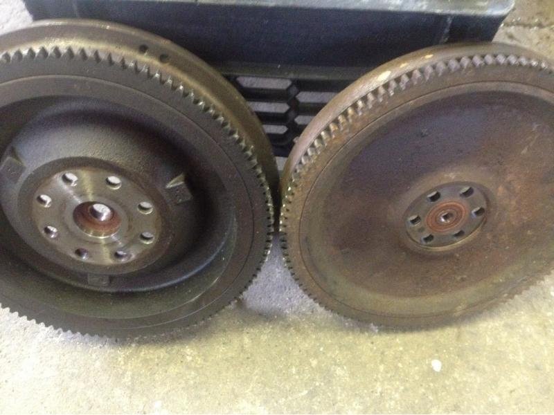

Right, j20 flywheel, left G16 flywheel (cable clutch)
You can see the depth and size difference as well as the bolt pattern difference.

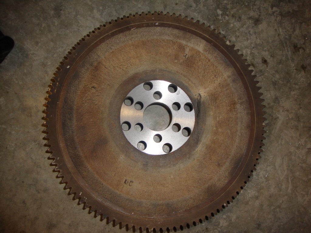

Not my pics but a machined G16 flywheel to run the J20 on a 1.6 gearbox with cable clutch.

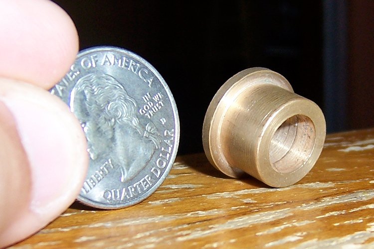

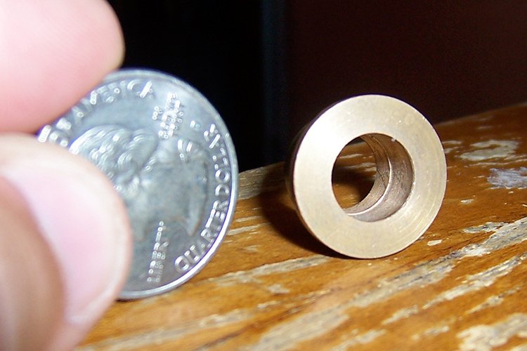

and the spigot bush to support the gearbox input shaft,
