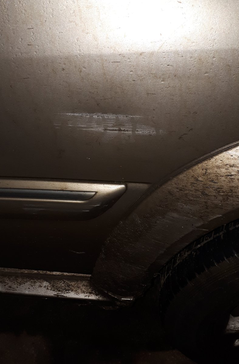

The GV has plenty of scratches and chips on the roof from carrying all sorts of bits and bobs. Most are minor others are deeper so was planning on touching up in places to keep the rust at bay. Today one of the delightful kids decided to push the metal gate into the passengers rear side door while I was passing through so it's made a nice gouge along it
Now could do with getting it painted sooner rather than later. Appearance wise not bothered about colour difference or trying to hide where damage has been just wanting it covered to stop the rust. Any recommendations on how best to go about it and what paint any one uses?

Probably 4-5 inches where it's down to the metal

If your’re not too bothered about looks, sand it, some zinc primer and get a paint match done at a paint suppliers who will mix a rattle can in the right colour.
Due to fading and ageing it won’t match 100% but will give a reasonable finish and prevent rusting.

Cheers jordi sounds a plan I just want to keep the rust at bay not bothered on looksJordi wrote: ↑Wed Dec 09, 2020 9:33 pmIf your’re not too bothered about looks, sand it, some zinc primer and get a paint match done at a paint suppliers who will mix a rattle can in the right colour.
