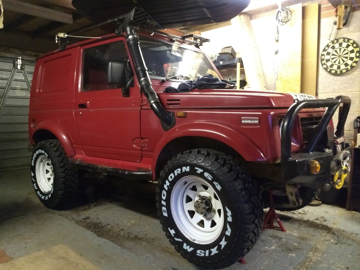

Not long after I bought it with winch fitted

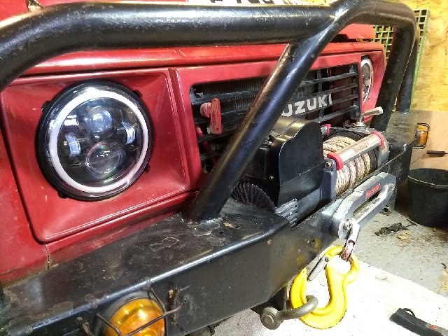

How looked last weekend, new led headlights fitted but not wired yet. Contemplating a light bar too to replace halogen spots that I've just removed.

Looking good, just be aware you might need to swap the headlights back for the MOT, A lot of the LED headlights available don't have the correct pattern to pass. My dad ran into this issue with his.

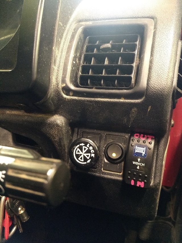

Post by Larry » Mon Nov 23, 2020 1:42 pm
Finally got around to tidying up my winch wiring. Got rid of the plug in lead, put a Carling switch on the dash and relocated the isolator switch from beside the battery to protruding from the front grill, so that it's easily reached in the event of an issue with the winch. Much safer 👍
