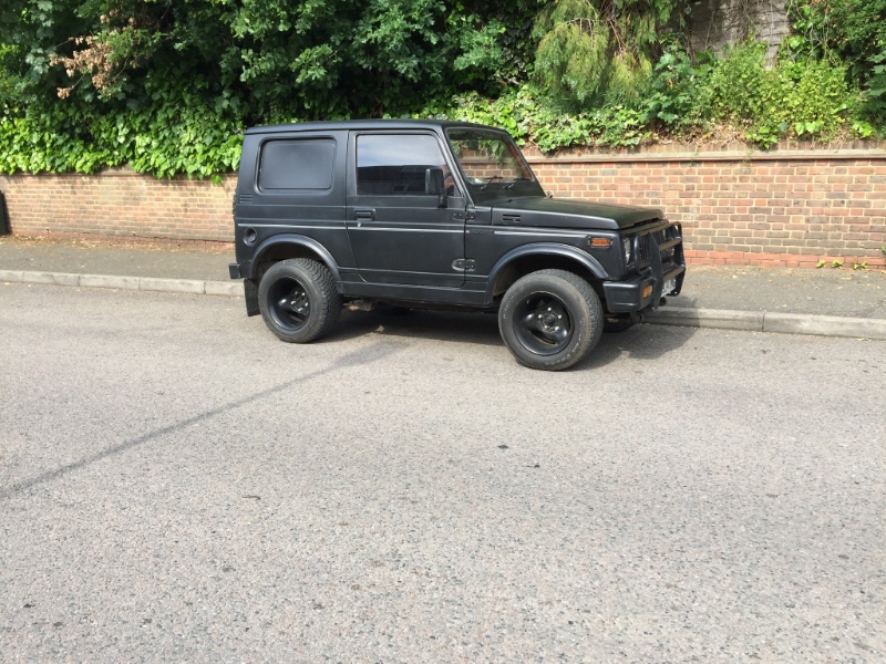

This is my little 410 I drove around and looked a few before taking the plunge on this one .
It had its issues I think I overpaid but that’s the way it goes

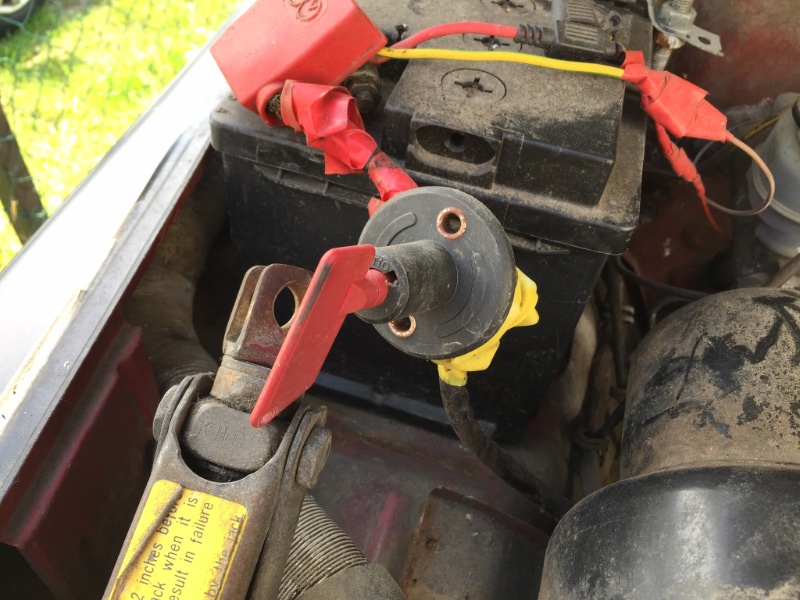

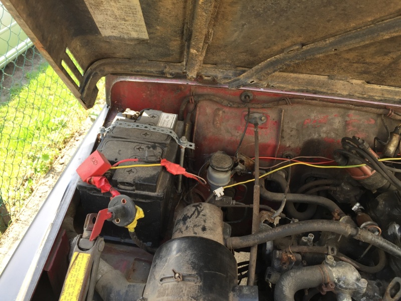

The main power cable that powers ignition was just push into the positive terminal .
I drove this home in the dark and it could of just fell out hahaha

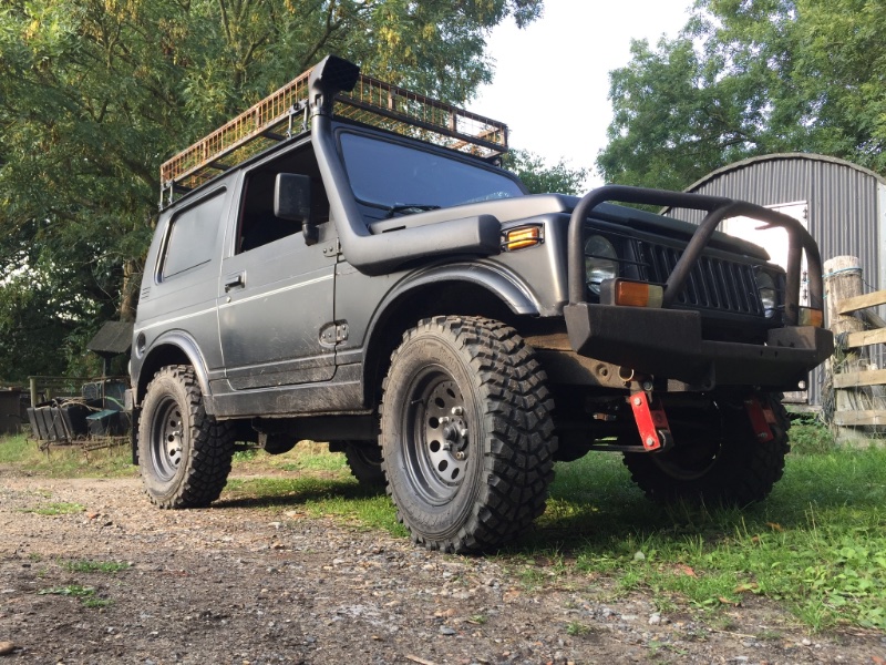

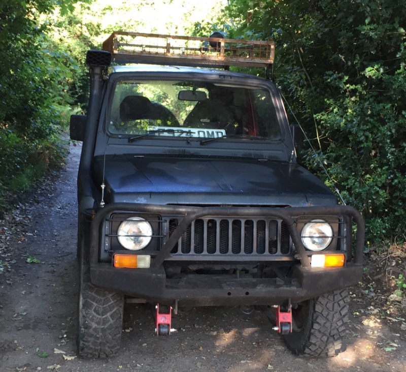

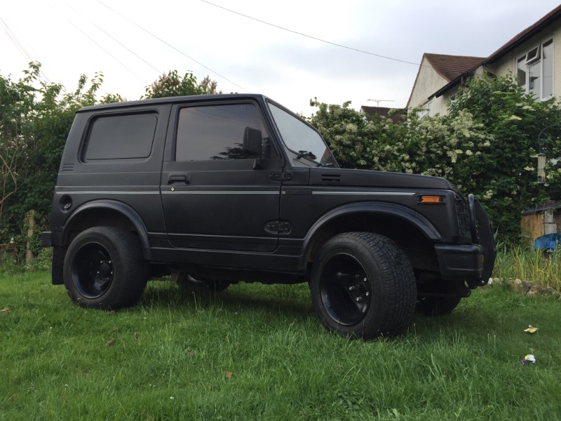

I did away with the odd alloys in favour of a set of wheelers 215/75-15 insas
Later to go was the bumper for a winch bumper

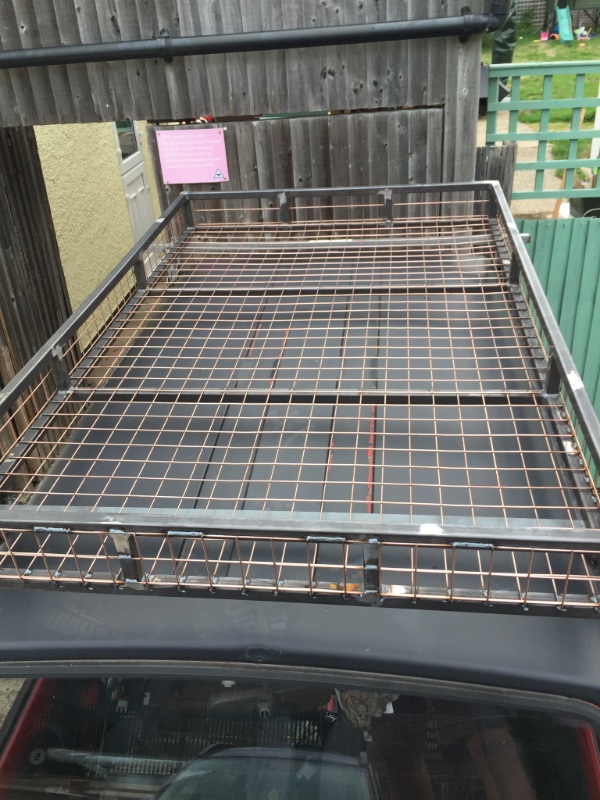

Fitted a roof box
Gave the little 410 a new exhaust cam belt oil filter and pulled a lot of bodged wiring out
Fitted a little set of shackles

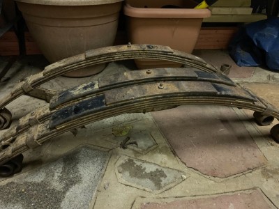

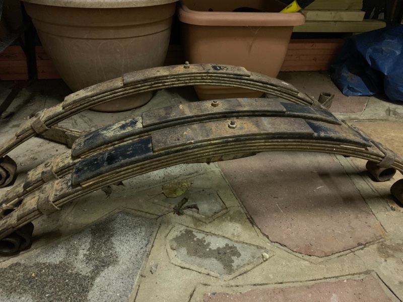

I’ve got the 3” calminis I might fit but might remove a few leafs from the pack as I’ve read they can be STIFF .

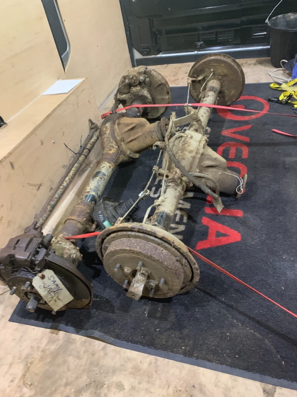

Axles there as well as a vitara servo
Hopefully got a high steer kit sorted
I’m just toying with the idea whilst the axles off to do rear disc brakes using the sj fronts up rear

I’ve taken callipers and discs off front axle
Waiting for my bro in law to Knock up some perches out of some 3mm box
Once there done and all set up and welded on I can push on
Going todo rear disc conversion whilst it’s all off.
Trying to get hold of the guys at Muddyzook to get a bolt on kit
Looks like I might have to quickly do a pinion seal on the rear diff hopefully I can sort that by popping one out and popping one back in .
Gotta strip the rear brakes off to get ready for the conversion
