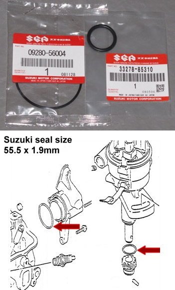

Does anyone know the thickness of the oring that fits on the back of the distributor casing, got a perennial oil leak i would like to cure. I measured the od at 60mm the groove it sits in is 2mm.
Just so I can have a rake around at work rather than buy one!
Samurai Distributor Casing O Ring Size

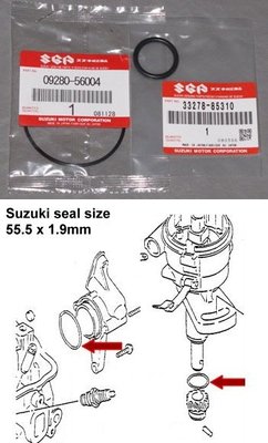

I have this in my archive.........
