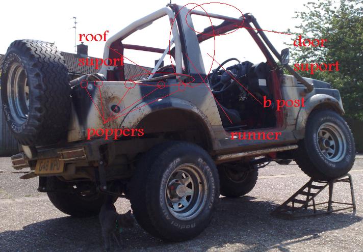

you will have a hard jod 2 do that.
you will not have the fixing point ova the window. + 2 popers
you will not have the runners for the top down the back off the cad.
also the poppers round the back and door.
an for the b post and door frames you will not have them when cutting your old roof off.
also you will be left with no thick ness in the back where you cut the side panels off
hope this makes sense??
ill try an show you.

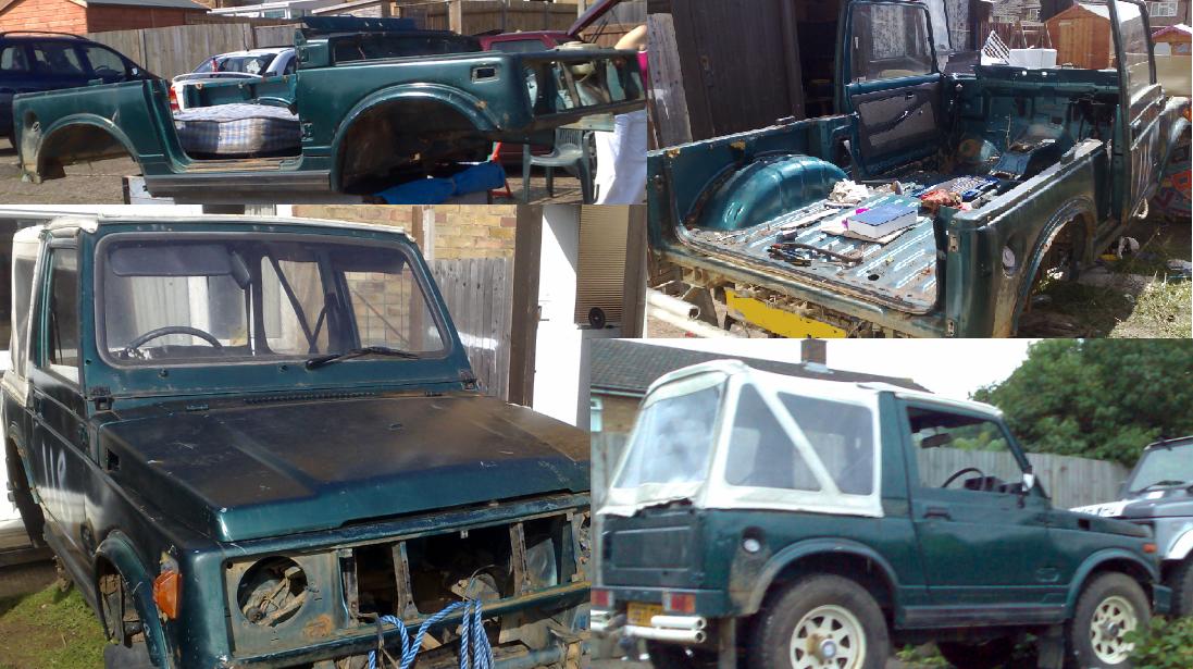

but on the up side i have a soft top body thats just sitting round off the frame only thing its missing is the f window well i have one to fit but the glass is smashed.
an id love to swap it for your tin top as i wanna pick up my other anus.
is bin striped an stored in my garge flat pack styel. i got the anus as a donner for mine no bad rot.
it is all there only took me 5h to strip an will help if you need it. where are you?

Your best bet is to pick up a soft top body and fit the new body onto your chassis
Re: Difference in body styles?
Post by dan_2k_uk » Thu Jul 31, 2008 8:46 pm
soft top body sounds like best plan. Might b able to find one that comes with a soft top with it so u dont have to buy one.
urbanzook
Posts: 526
Location: stevenage
Post by urbanzook » Thu Jul 31, 2008 9:02 pm
i must add iv not got a top 4 it as it was lether an cracked an split befor i stored the car.
so you will still need one
