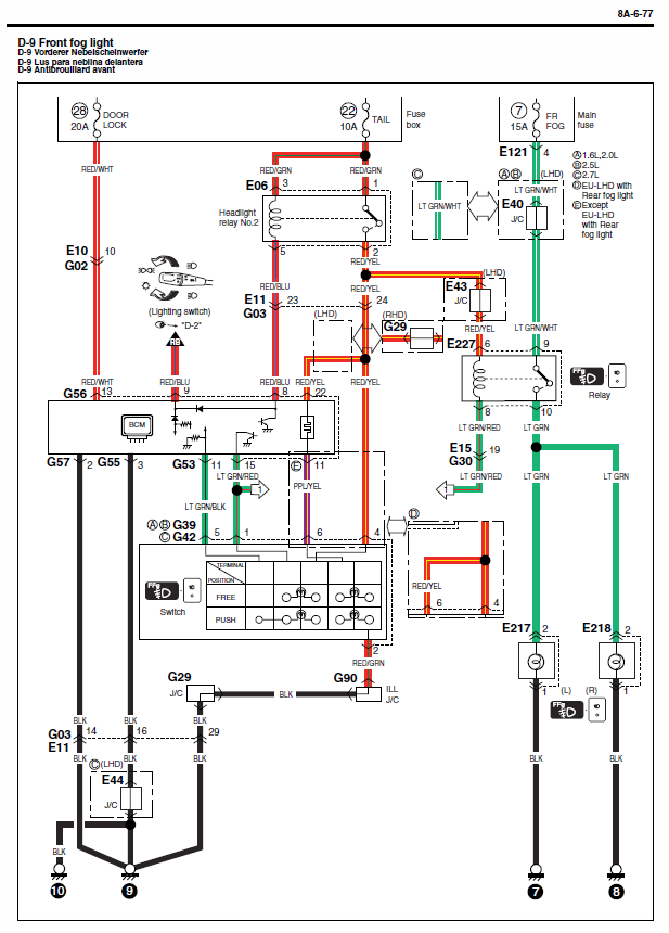

Grand Vitara 2004.
Current in my front bumper there are no fog / spot lights.
Is there a loom which is mounted in the engine bay where once I fit the lights can then be connected or
Do you need to start from scratch and install it all.
Thanks.

Post by Darrell » Thu Dec 07, 2017 10:09 pm
You need to check the wiring is in place. If so you just need the lights,switch and probably a relay/fuse installed in the appropriate sockets.
GV SQ 2003-2005 front fog.png (81.87 KiB) Viewed 4537 times
