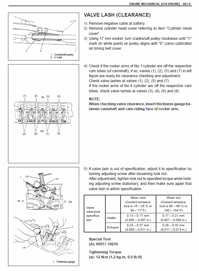

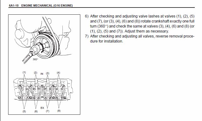

So before you ask ;)
From the Grand Vitara workshop manual.
dreadnought
Posts: 3
Joined: Sat Mar 25, 2017 5:20 pm
Re: tappets
Post by dreadnought » Mon Mar 27, 2017 7:05 pm
cheers guys, top advice. will be getting on with it at the weekend.
