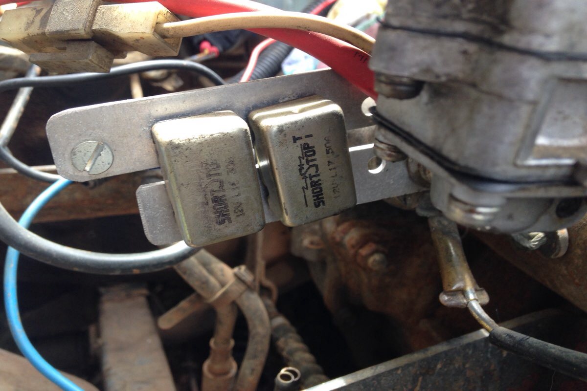

Post by ROBBIE » Sun Jul 10, 2016 9:56 pm
I can't get the LJ started and I noticed this isn't connected to anywhere, don't know if it ever was. It's under the carb and doesn't look original so don't now even if it's needed
Re: What is this?
Post by Darrell » Sun Jul 10, 2016 10:43 pm
Those are circuit breakers. Protecting one busbar to the other using both. Very strange :er: :er:
Will need more piccies to work that one out.
Re: What is this?
Post by ROBBIE » Mon Jul 11, 2016 8:22 am
Thanks Darrell. The problem was I pulled some unneeded wiring for the knackered winch and dont know if I disconnected it.
The car has a heating system installed, that connects to your house, to stops it freezing at night. So suppose it could be part of that
Re: What is this?
Post by ROBBIE » Wed Jul 20, 2016 10:25 pm
Didn't notice on the day that this was on the starter motor, on the +terminal . So as the starter was engaging and spinning I've removed it. Cheers for the help Darrell
