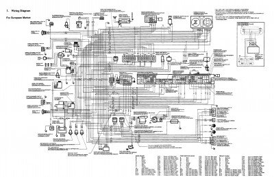

Post by mike harris » Sun Jan 31, 2016 4:37 pm
I can't seem to find a wiring diagram for the speedo and clocks anywhere?
Just need to know which each wire to the three plugs does?
Anyone help?
Thanks
Mike

Did you ever get a wiring diagram ?

i have same problem if got any diagram send it

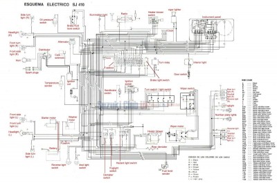

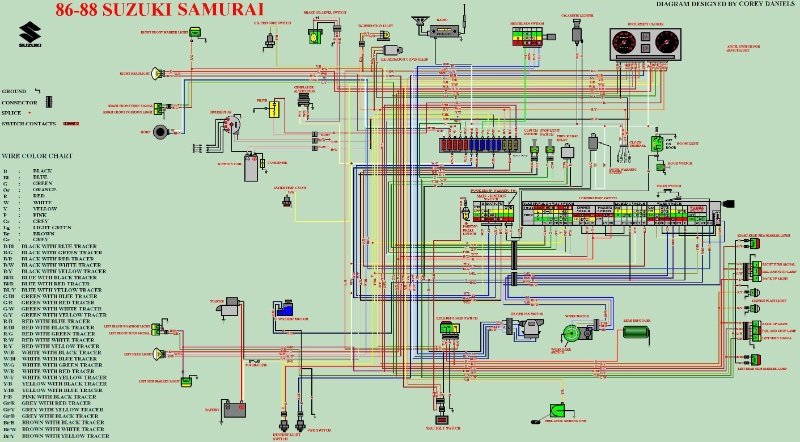

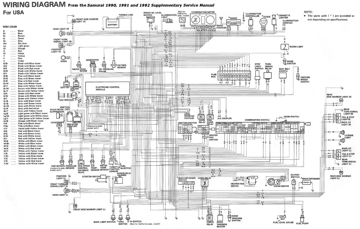

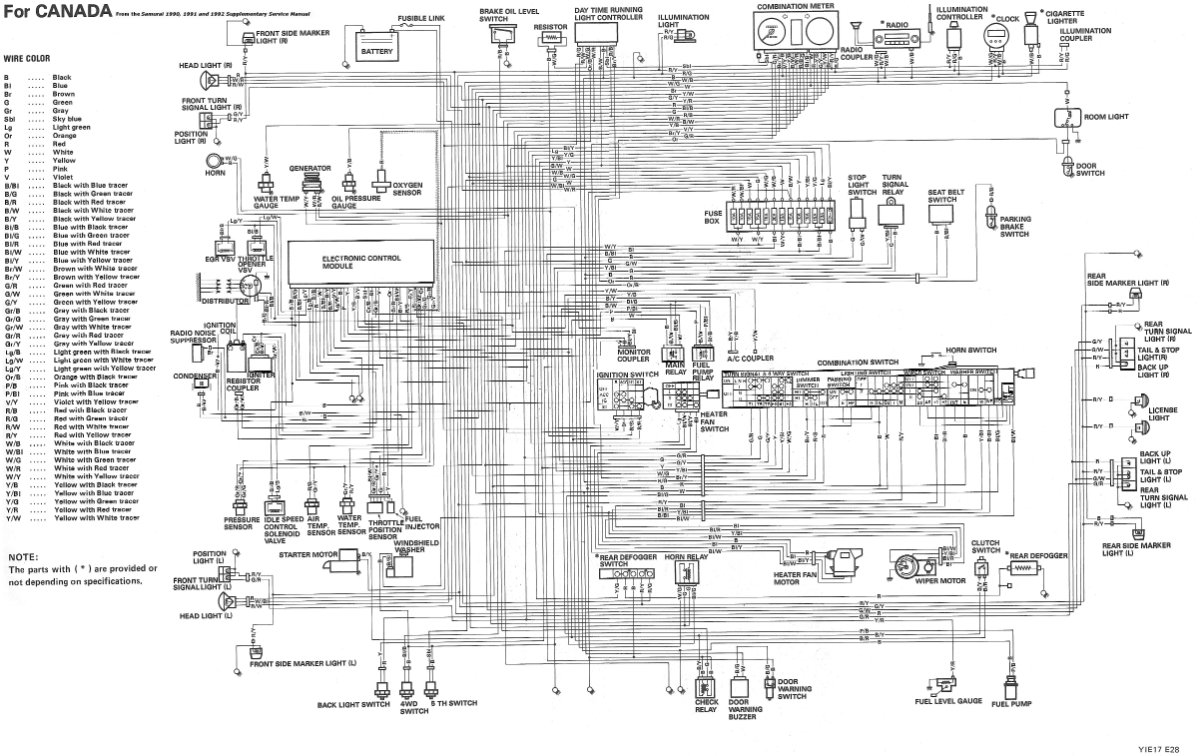

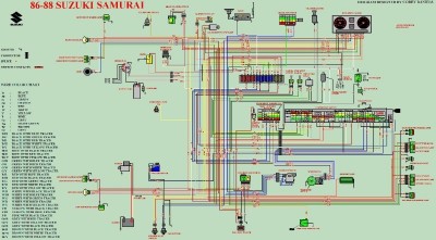

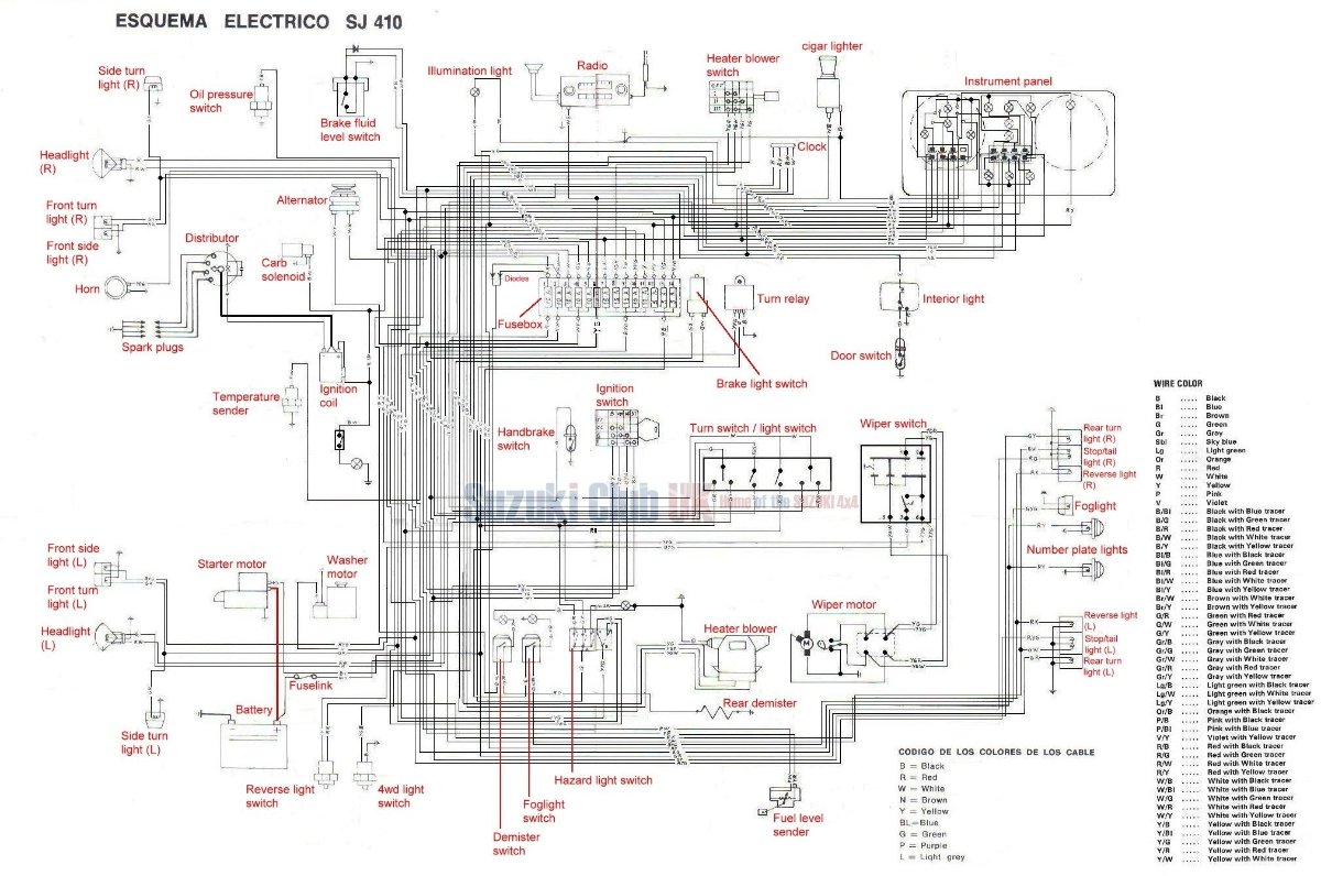

What model?
kiwitony
Posts: 14
Joined: Fri Oct 09, 2020 9:49 am
Location: Christchurch, NZ
Re: Speedo cluster wiring diagram needed.
Post by kiwitony » Mon Oct 18, 2021 9:23 am
A few manuals attached, The SJ413 manual I have is a pdf and not a supported file type to upload here.
