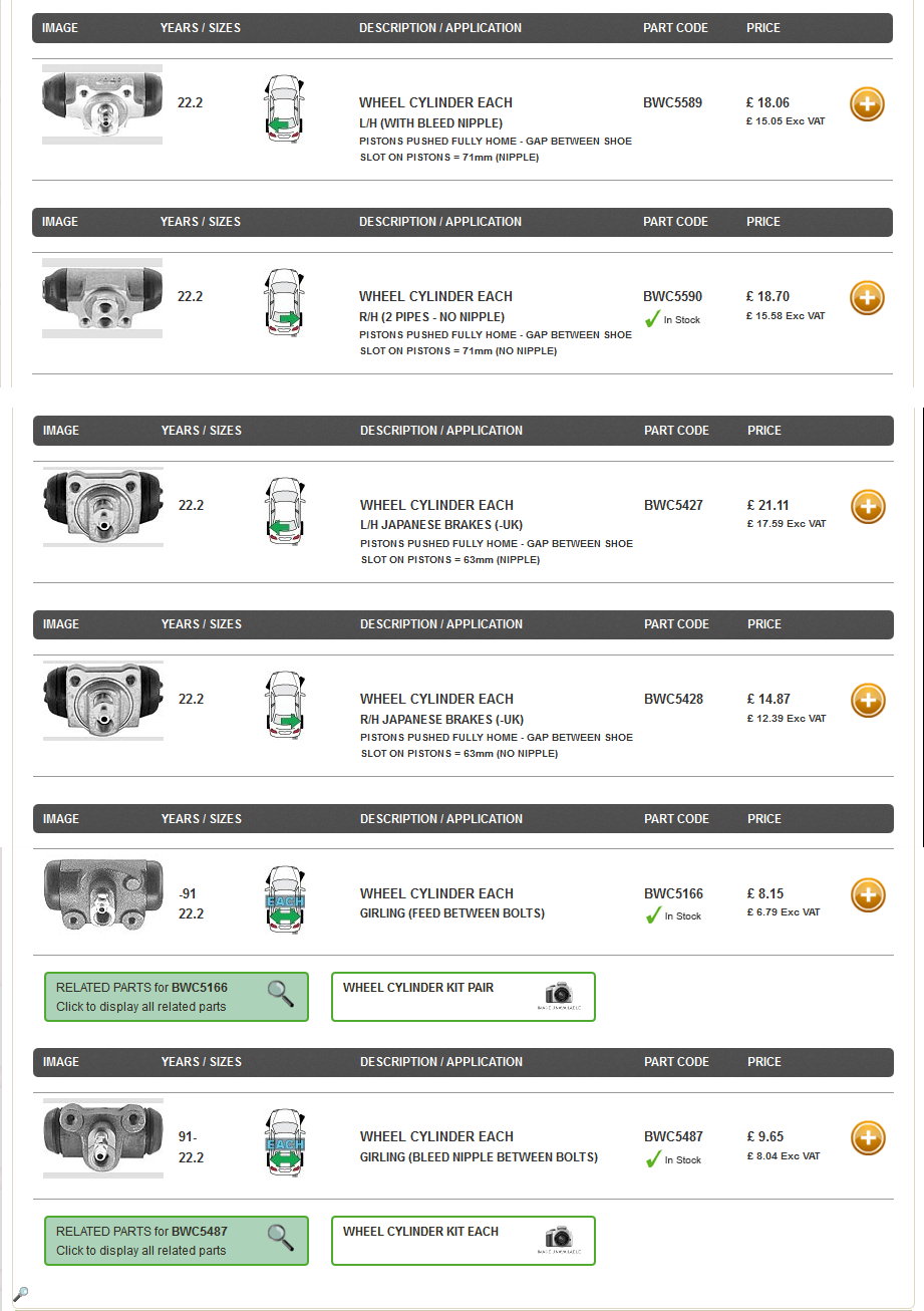

Post by Darrell » Sat Aug 09, 2014 11:45 am
Any help.
SJ 413 samurai rear cylinder types.jpg (207.59 KiB) Viewed 6439 times
Info saved from brakes international, so prices may be incorrect now.
Re: HARD ON
Post by Darrell » Sat Aug 09, 2014 11:54 am
Mine is the same year as yours and uses the top 2. (not that guarantees anything with Suzuki ;) )

Post by basil » Sat Aug 09, 2014 2:02 pm
Thanks every body for the info have printed it all out to take with me Monday
