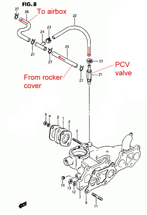

Just having a general "read up" on different things members have asked about as I'm new on the scene and I bumped in to someone asking about their engine oil burning problems. One of the inputs was talk about a PCV Valve used to assist in the burning of oil fumes and the possibility of it being unserviceable. I started to think about this and I'm sure my vehicle doesn't have this fitted - so obviously I need to ask if it should?

its that little thing that bolts inot the top of the inlet manifold and should have a pipe coming out the top with a Tpiece joining it to the air box and rocker cover.

Just helping somebody on "difflock" so thought I'd post it here as well.
410 inlet.jpg (50.4 KiB) Viewed 5292 times
