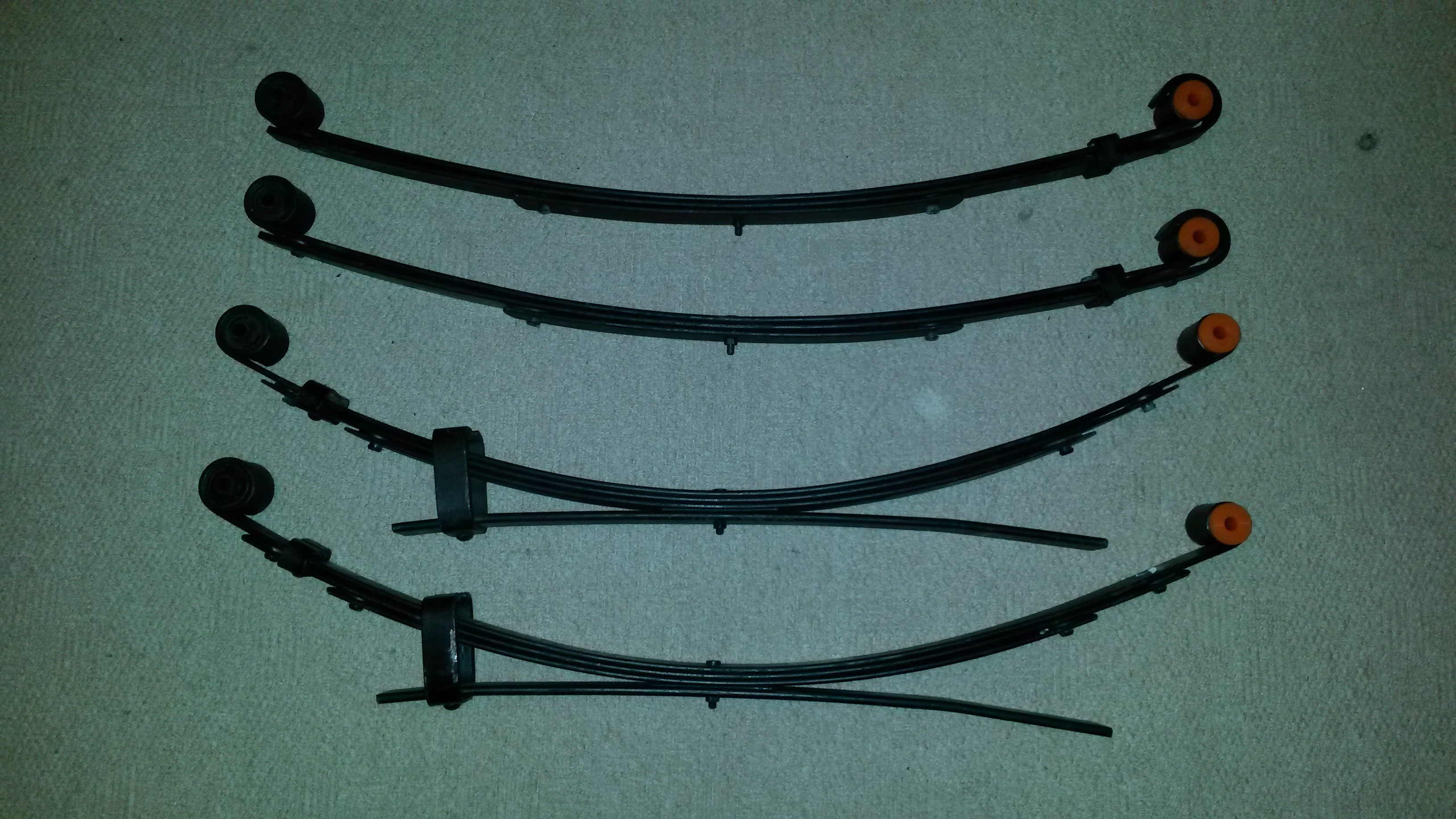

Got my new Springs delivered today. Cant wait to get them fitted (hopefully this weekend).
sorry for the rubbish photo will try and get a better one before I fit them.

Ordered them from a company called midland road springs. They have a two inch increase in camber over standard springs and were very well priced and only took about a week from order to delivery.

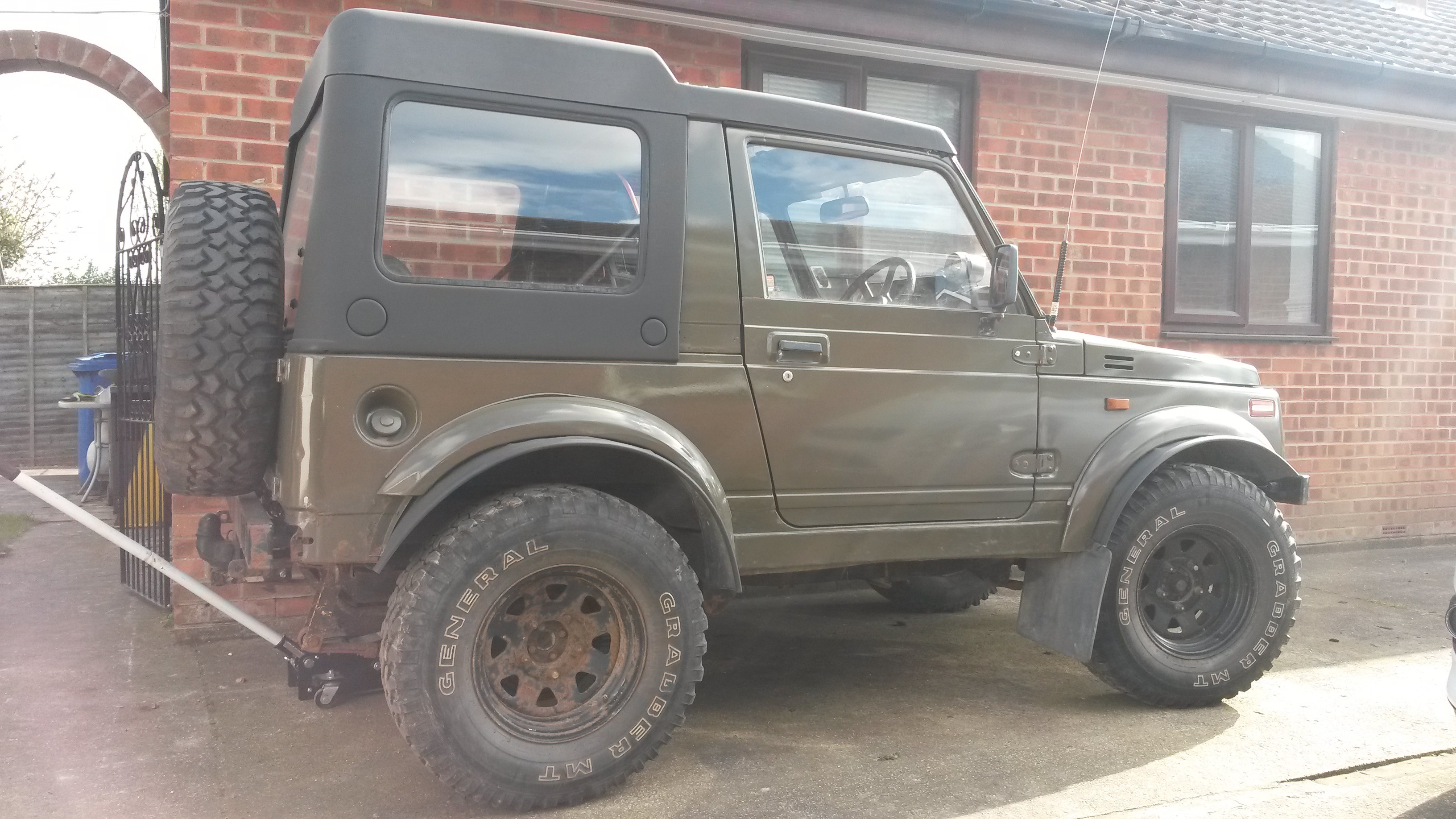

So started the sj rebuild/rejuvenation today. Here's how she looked before starting.

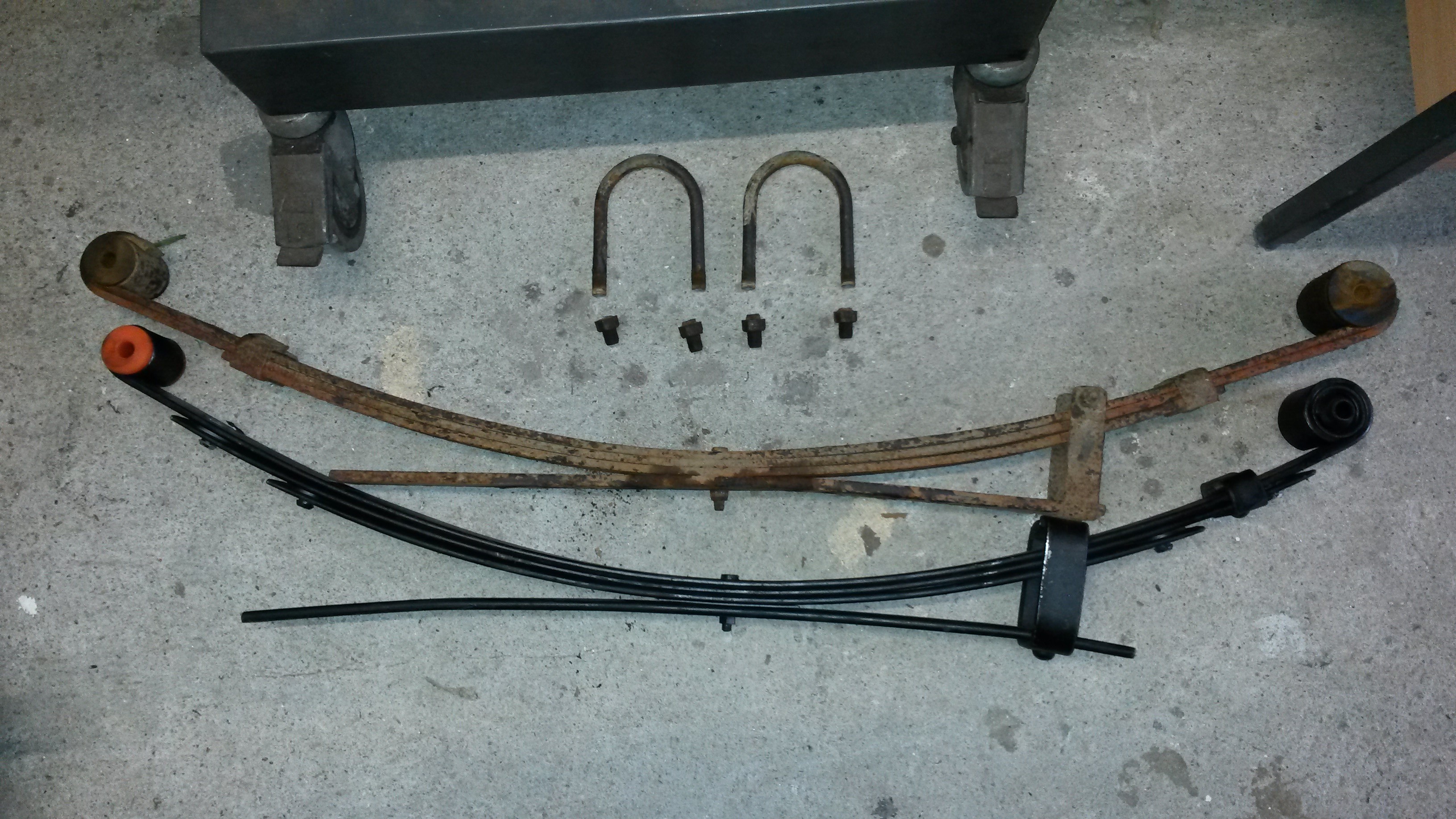

Have made spring over axle perches to weld on so i can go back to standard length shackles but keep the same amount of lift for my 31's. Also considering making front shackle reverse does anyone have any photo's of a samurai with shackle reverse kit fitted?
2014-04-20 10.42.43.jpg (1.37 MiB) Viewed 8819 times
Picture of new rear MRS +2" spring vs old pro comp +2" rear spring. And also 2 broken u-bolts.... b*!!*cks. Think I must have cursed myself the other day d'oh.
Does anyone know a place to get reasonably priced u-bolts at short notice?
