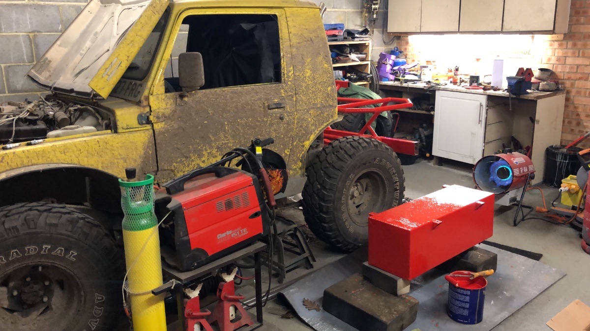

Fuel tank is drying nicely, in a very specific shade of red.

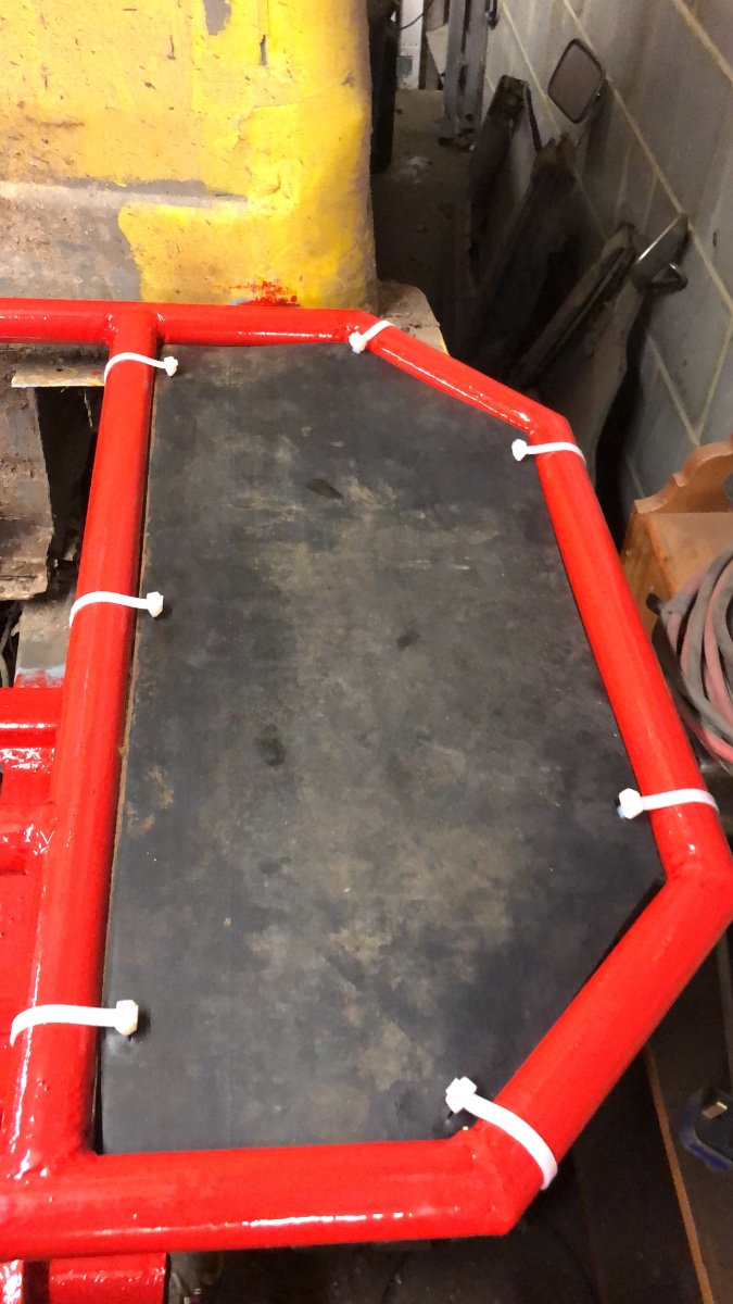

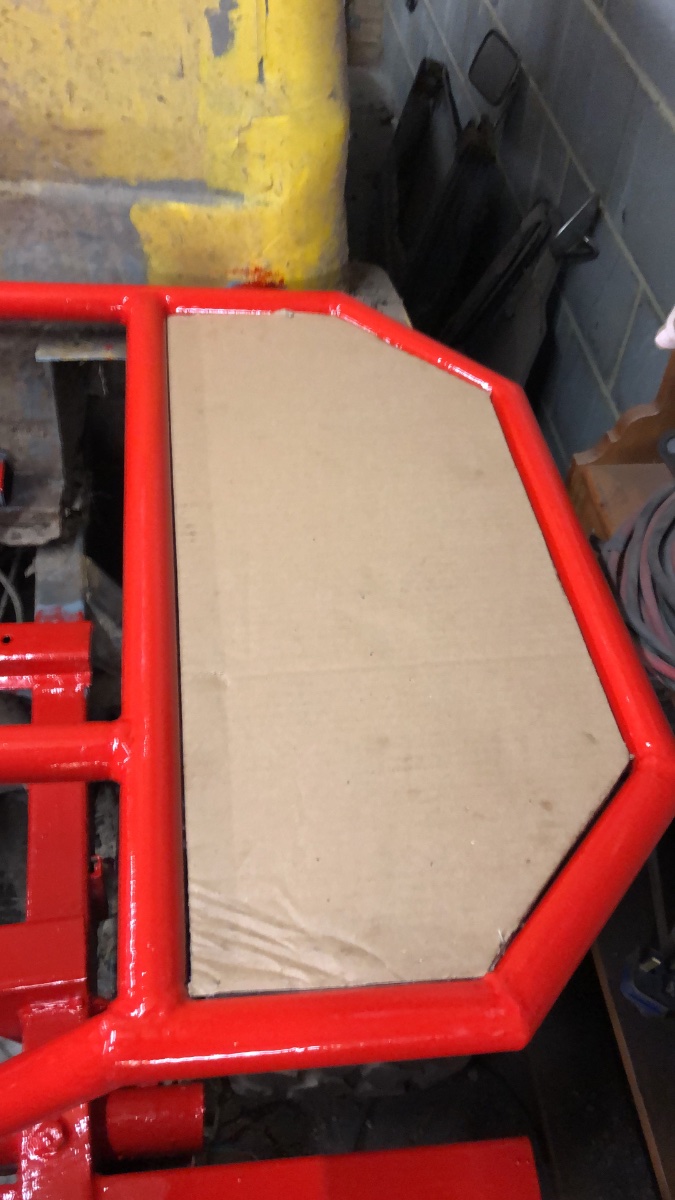

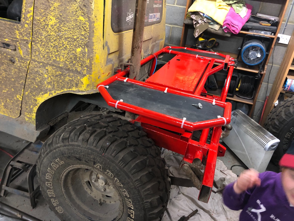

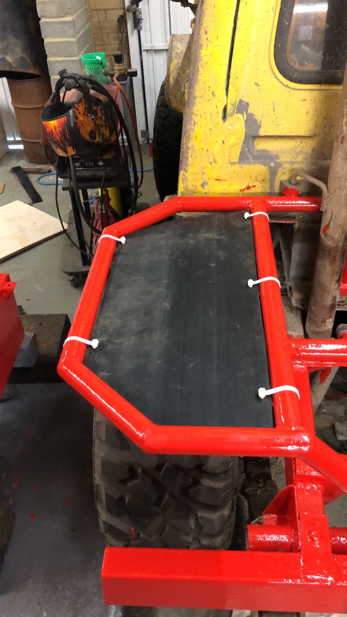

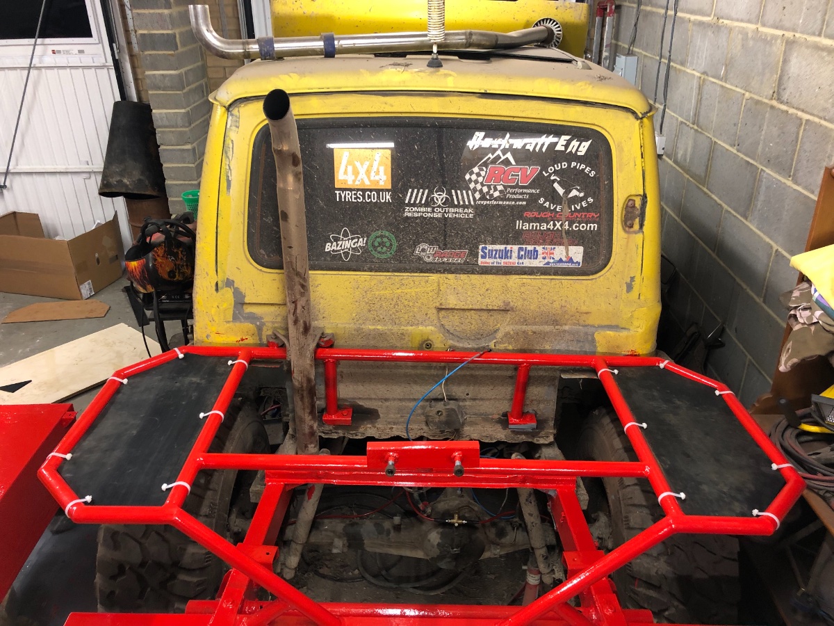

Bit of CAD to make the “temporary” infills for the back.

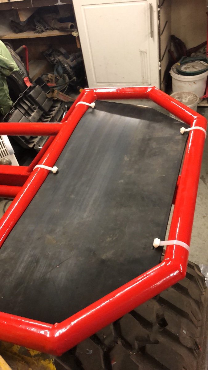

Using the universal SCUK shit rubber.
Not quite sitting right, needs an extra cable tie at the front and back.
Fits a lot better with the extra ties

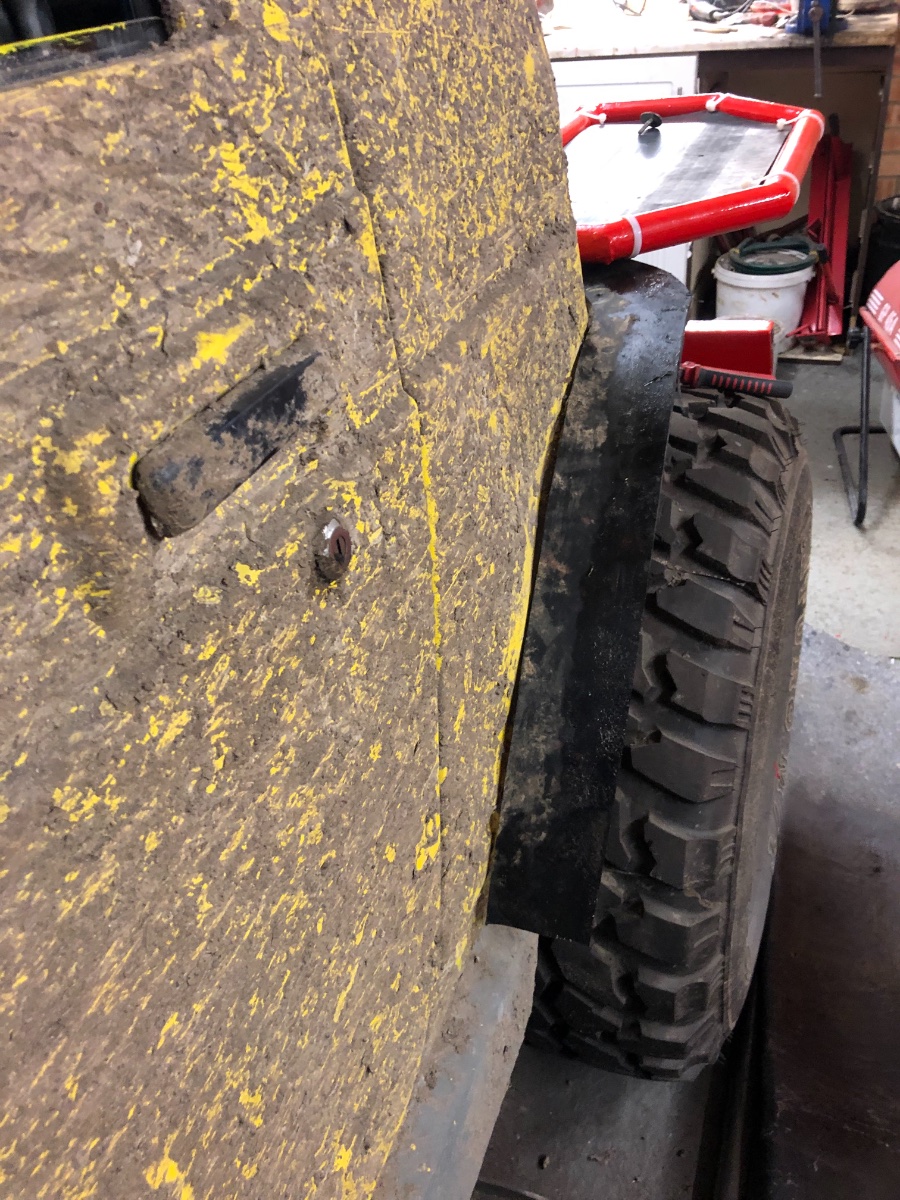

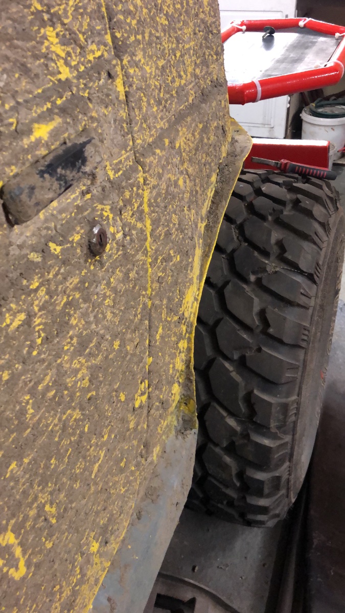

Little rubber spatz, more to cover the sharp edge than stop mud flying.

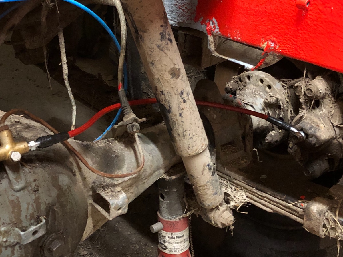

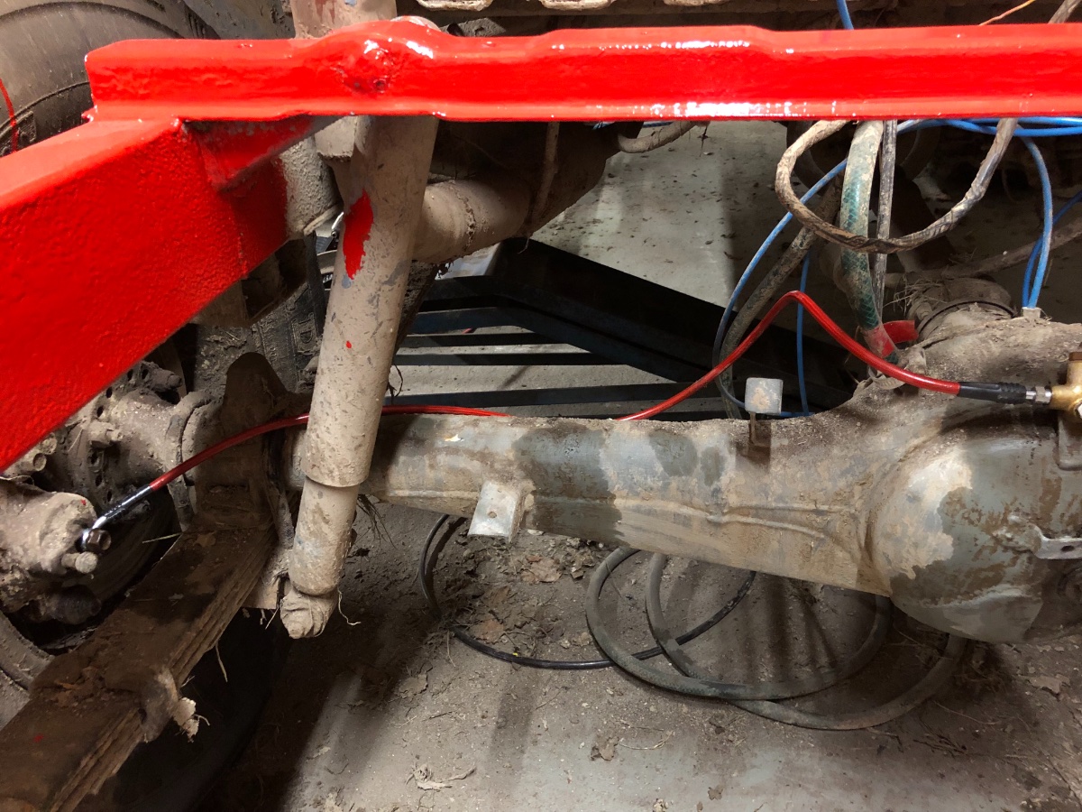

Braided hoses to run across the axles instead of copper and the old rubber flexis.

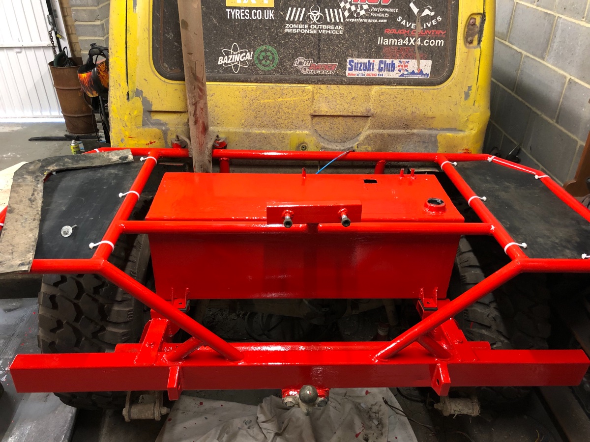

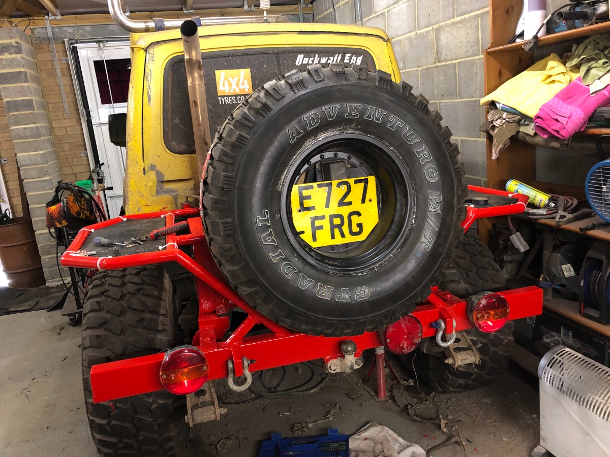

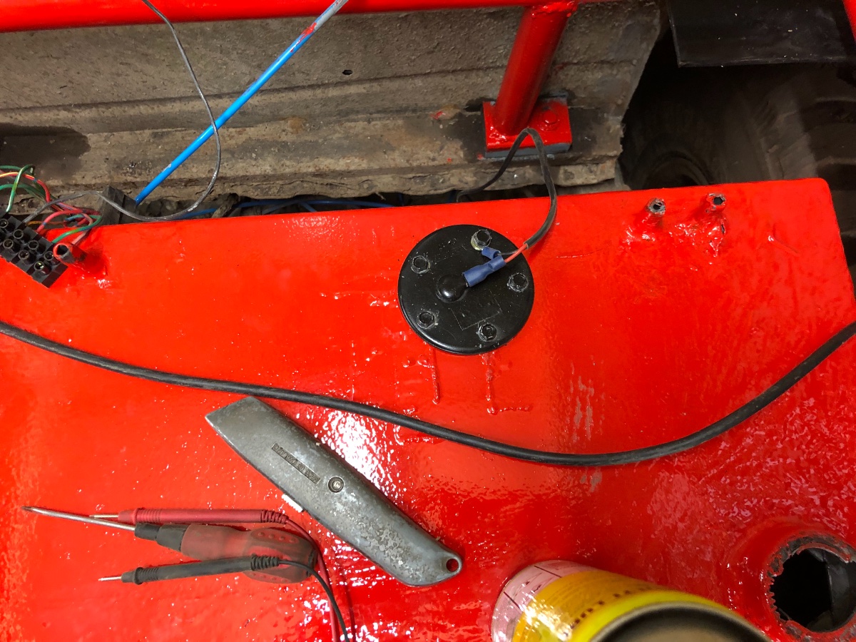

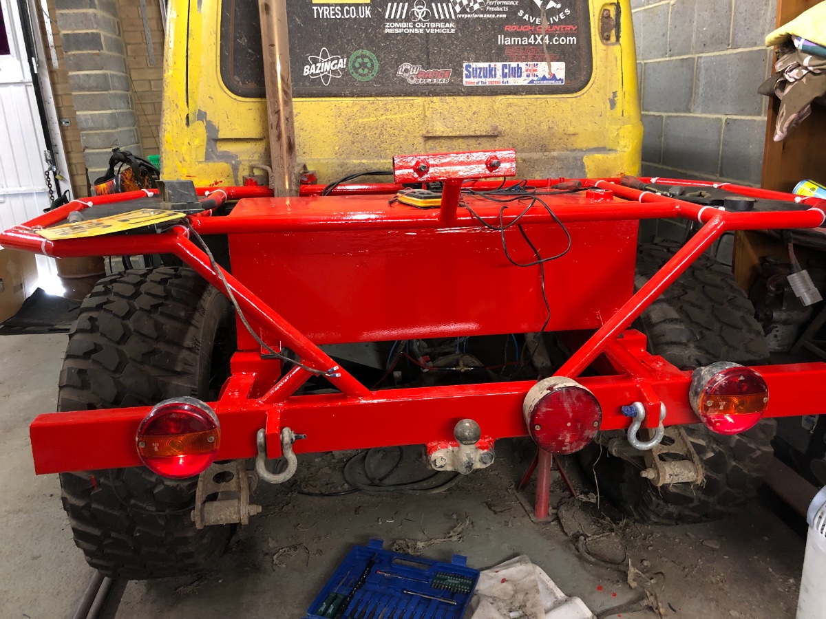

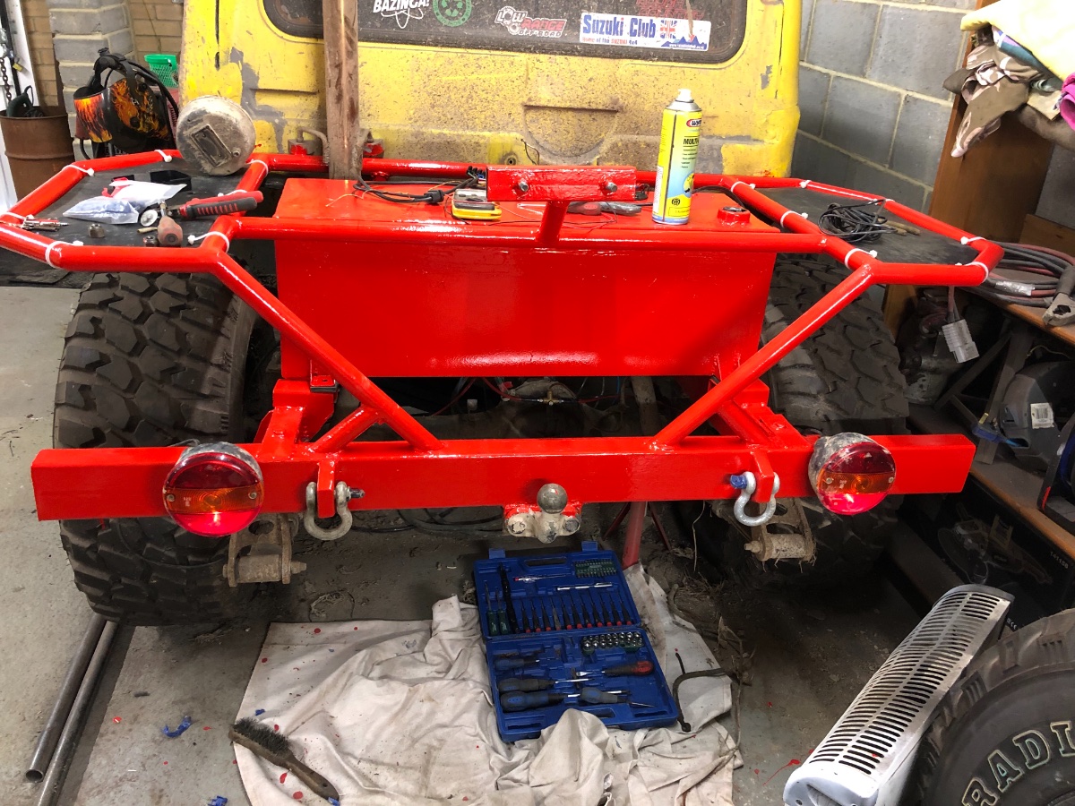

Tank is sat in place, back lights fitted, new fuel sender gauge fitted.
All the back lights seem to be working properly, wiring is still to tidy up, bolt the junction box somewhere.
Posts: 3859
Post by Anton » Sun Mar 17, 2019 2:23 pm
That looks mental!
What's the capacity of the tank? It looks like a lot more than the factory tank...
Posts: 7539
Post by Jordi » Sun Mar 17, 2019 3:41 pm
I honestly can’t remember the capacity. It is a lot bigger than standard though.
