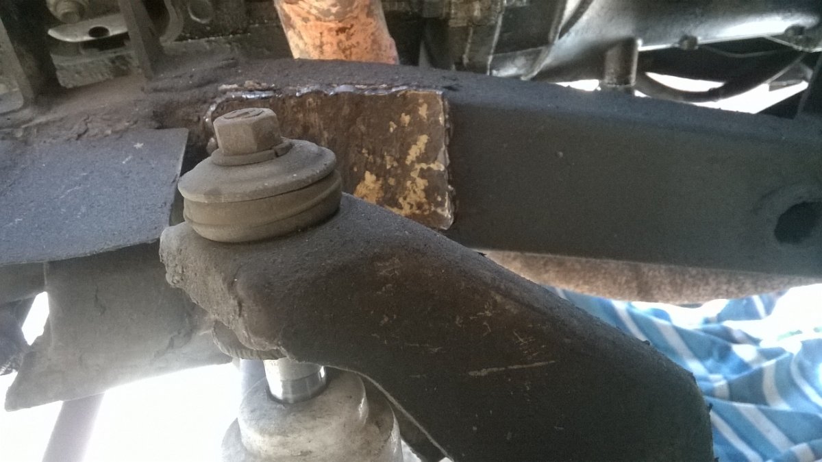

And now this has happened....
Might explain why it was driving like a bastard and getting worse as the mount sheared off bit by bit. I shudder to think what would have happened if I was doing 70 and it came apart.
Local welder will have it done by tomorrow morning. Still haven't got my new tbox mounts either!

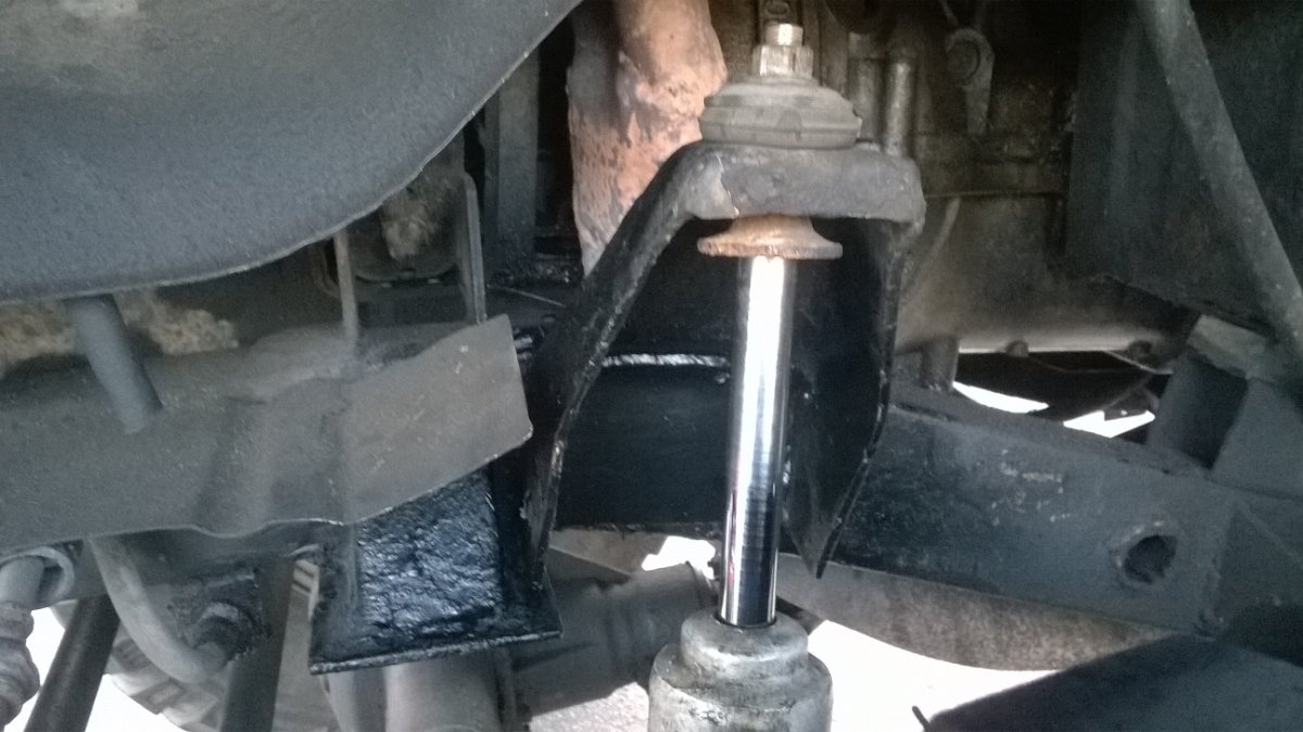

Post by donkeychomp » Sat Sep 21, 2019 10:27 pm
All done and a very good job too.
Tbox mounts are here and they are the proper ones! And not as tall as mine...
